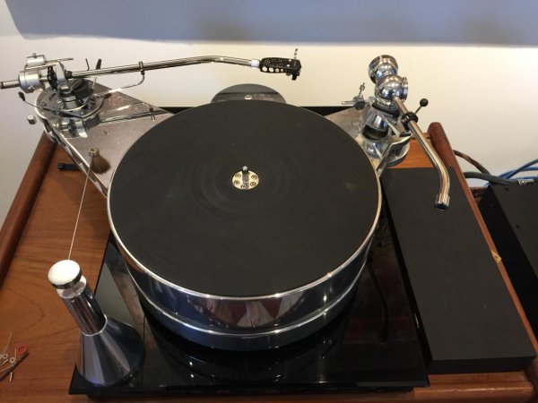

Lots of manufacturers, dealers and audiophiles talk about the perfect platter-LP impedance match. In the cases I cared to research - like AMG, Basis, SOTA et al - some seem to be converging on a vinyl-to-vinyl solution of one kind or another, or PVC-to-vinyl, or some other form of plastic, resin or other. The new Basis super platter, for example, touts its some-sort-of-vinyl-based layer on top of the platter.
I am building my own impedance matching solution, which so far partly depends on a thin layer of Isodamp - another highly damped vinyl, possibly coupled with Spec's AP-UD1 (still in evaluation phase) - and it appears to have hit the nail on the head, with excellent damping, evidenced by the tightening of the bass with exceptional reduction in overhang, increase in leading edge attack and clarity, smoothness of choral works, and obviously, a reduction in mechanical noise... among many other improvements (I may post the final solution under my system thread one day).
So I was curious what others know about this subject, and how do you approach this type of mechanical impedance matching.

Thanks for the responses so far. One thing is clear to me so far, vinyl sitting bare on a plain platter - of any material - is not cutting it. This impedance is critical, and moreover, I just don't think simple and soft materials like leather are sophisticated enough, and neither is carbon fiber for that matter.
Peter, there is a thin layer of clear film between the LP and Isodamp; I may well end up with Isodamp/Spec/Isodamp, but time will tell.
PS: I am intentionally not calling this interface a 'mat'

Ack, two questions:
1. Why not call this interface a "mat"?
2. Does not the Isodamp material require a great deal of load (compression) to function properly? With such a large area (platter surface) and such a light load (vinyl record) this requirement will not be met unless the material is paper thin and a great deal of pressure is applied with a center clamp and periphery ring. Perhaps in this application, the material does not need to be compressed, as I noticed a dampening effect by simply placing some Isodamp scraps on the top of my amplifier casework.
Ack, two questions:
Well, what exactly is a 'mat' - is this like a carpet? It's an interface, and it needs to be treated as such
I am using 1/16" thickness, which probably doesn't need to be compressed, but one of the reasons I am experimenting with the Spec is the additional, though small weight it adds (about 400g).
