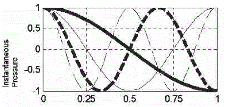

I'm wondering if for a rectangular room you couldn't have a positioning rule of thumb (for subs or LF woofers of speakers) in terms of % along the length and width of the room that would work in all cases seeing as the standing wave pattern always takes more or less the same shape in this geometry.
Am I right in assuming you want the woofers situated as close to 0 instantaneous pressure as possible? This shows the the first through 4th modes along a single dimension.
