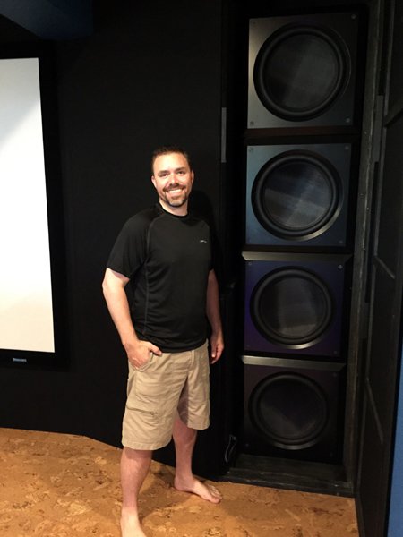

I tend to prefer the results achieved from this dual stack of 8 separate sealed modules (18" driver, 23.5" square x 18" deep) I just installed a few weeks ago:

Is this where your in wall subs are located?
Those are the subs in the one wall. There are multiple sets.
Where's the one in the ceiling?
I don't have a picture of that handy.
Crossover points?
80 Hz.
(Eidt) Is this a picture of your actual listening room or a rendering?
david
It is the real room. Everything is normally hidden behind fabric though. We have a set of LED lights that when you turn them, you can peer into what is behind them. Here is a side-by-side view, with and without back light:
