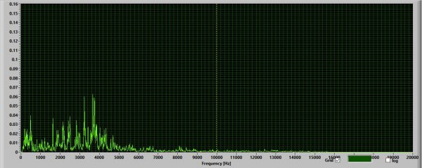

Agree, but there's something more going on, 175% THD is insane. Sure distortion is likable, it's being done on purpose in guitar amplifiers for example to make the sound richer, but this is really too much on a video. So I suspect the microphone is distorting in video 1.
There does seem to be a repeating issue with the CMS videos, notice the same spikes in analysis of the other video recording here:
There are 3 very evident spikes, these appear to be resonance spikes. Some sort of unfavourable interaction between the ML3s and the CMS perhaps, or it's chassis resonance which the Daiza has been specifically designed for to address.
