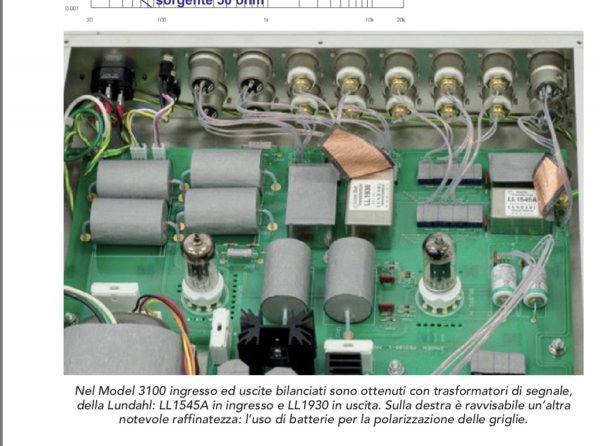

I have no doubt the transformers are indeed by Lundahl. No other manufacturer offers amorhous/mu-metal units in that specific form factor. And most other manufacturers do not like using the term mu-metal when describing a core containing nickel.

Yeah these too are Lundahls based on appearance. Zanden has painted over the poly caps, the Lundahls, and even the Kemet relays, I suppose to conceal their identities.

Perhaps so, if you enjoy a cynical attitude :) It is also possible that the damping/rf blocking covers are indeed essential. These, combined with some expensive hook-up wire may really contribute towards the desired sound signature.

LOL. Most people are skeptical. There have been all sorts of audiophile coatings, quantum stickers, other nonsense over the years. They come and go. This is paint. They left the cap leads and flyover wires unconcealed.

I'm am hoping the MK2 would use transformers good enough to not require a parafeed topology. I'd rather see no caps.

Apart from the very nice and expensive attenuator, everything else has been masterfully obfuscated. No paint or damping materials on the pot though...
As the parts bins for the 3000mk1 and 3100 are pretty much known, is speculation really out of order?
