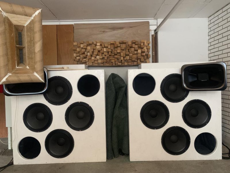

Am waiting for a big synergy horn system that will arrive in the first week of June.
Mid/high cd is JBL2451 beryllium, mid bass is 2X18Sound 12" drivers. Sub enclosure has 2441(i think it is), 18" driver in 340 litres cabinets. 80cm wide. Reading this thread makes me even more impatient :D
The "brain" for this system is a GroundSound dcn28 unit.
Will report back with impressions and pictures when it is upǹ running.
Cheers
Here are the speakers ready for shipping. I hope to have them on Friday or Saurday this week.
Total is 80cm wide.
JBL 2243, 18" sub
Horn:
2X18Sound 12ND610 each side
JBL 2451 beryllium
Crossover from sub to horn about 150HZ/LR24db
The system will be fine tuned with a microphone/soundcard later this summer/autumn by an expert on this field. Then the speakers will be integrated in my listening room. Right now i have got the digital crossover for the synergy horn but the bass i must tune in myself, with some help.
Fjordfunk, really nice speaker setup. Looks like there is a secondary flare in the horn. How low does the tweeter play? Is that some kind of slot loaded bass reflex?
Reactions: Fjordfunk
One of the horns did not have the drivers mounted when picture was taken. Subs are 18" JBL in 340 l bass reflex cabinets.
Today they arrived, finally.
What is "shocking" me is the extreme wide sweetspot. They act like point sources. Capacity is also extreme. Now i only have dialed in by ears the subˋs. Later there will be taken measurements by the designer of the system to fit the sound to the room. The lack of distortion makes me play too loud i can feel now. I feel dizzy and my ears bleeds :)
Very happy right now. The build quality is furniture grade and they are so heavy. Glad that they are in two parts, horn/subˋs
Subs are now crossed at 180hz 24db/LR. Then the 18Sound 12"ˋs are taking over. The mid/high i am not quite sure of where it starts since the crossover is pretty advanced with so many settings. I guess the mid/high comes in about 600hz or so?
Any updates on your speakers? How far into fine tuning them have you gotten? Hope you are enjoying them.
Hi and thanks for your question.
The 17.this month i will get expert help to tune them in. The horns i think is good but we need to integrate the subˋs to the hornˋs. Some delay and other adjustments. Sounds very good now but i can hear the sub-bass is not 100% integrated with the rest.
