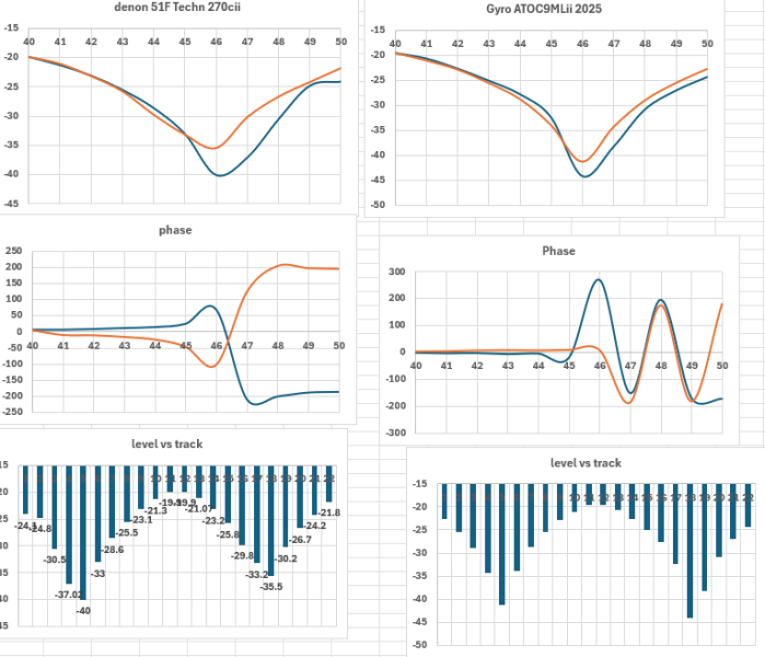

I rather have good separation than care about the phase of the crosstalk signal . My understanding is that it will be in phase in one direction and out of phase in the other
This diagram may be helpful to evaluate Azimuth effekts.In this diagram I interpret the crosstalk signal to be IN phase, if angled more counter clockwise the crosstalk signal would be OUT of phase., For the Left channel the crosstalk starts here OUT of phase.
Ideally the Phase switches direction/ crosses when azimuth is perfect, and crosstalk minimum, but I guess Zenith and VTA complicates the response too..and the stylus may not be aligned with the coil/magnet complicating things further,

Crosstalk and phase vs groove angle -(Merolemez Hungaton test record) by using Analog Magic V1
Record has first Left groove signal for crosstakt to right at 50 to 40 degree modulation angle, then right channel high signal is modulated 40 to 50 degree. 45 degree is same as 90 degree azimuth of course. see text below . If Crosstalk is minimum at same degree alignment is good, ideally that happens at 45 degree , I always get 46 degrees,trying to match minimums at 45 degree is not successfully in my case
Left cartridge is set up using Ultimate Test record, right c with Toshiba

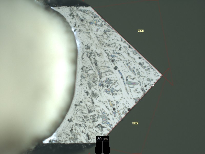

Here is *part* of the answer as to why different records offer different crosstalk results. These are cutting styli we are analyzing. Notice the cutting facets are not 45 degrees to the centerline of the shank. Admittedly, you cannot see that measurement directly in these photos because prior to the final (top, "Step 4") photograph we confirmed the stylus was completely orthogonal to the frame within +/- 0.15 degrees (conservatively). We then zoomed in and measured the cutting facets against the frame. It should be 45 degrees, of course. This is NOT the worst we have seen.
These are not stacked photos. Such photos are NOT reliable to take measurements from.
Of course, this situation is also NOT a reason to throw our hands up into the air and declare the effort of optimizing for maximum channel separation and phase balance is fruitless. It is completely worth the effort due to the tendency for the statistical error of such cuts and cutting styli to be symmetrical about the mean of the distribution of all cuts! HOWEVER, it is also still an excellent reason to distrust any test record which cannot first provide for you how the engineers controlled, measured and maintained their own cutting accuracy on all four angles, the cutting path itself and the symmetry of the cutting stylus. Until then, enjoy the music, but don't trust the records to put your alignment at the mean of the distribution of all errors. Step 4 - 211104_ch00.jpg

We are talking about two different things and I don’t think we fundamentally disagree at all. You are correct with your point about the thrust rod 45 degree orientation, but I am not referring to that.
I am highlighting the risk of cutting crosstalk into the groove AS A RESULT OF STYLUS ASYMMETRY - which is one reason why test records differ in what they tell us to do on the playback side for playback azimuth adjustment.
A cutting stylus with 92 degrees cutting groove angle but with 46/46 degree channel facet angles will cause crosstalk cut into the groove but at least with the crosstalk being in phase with the main signal.
Alternatively, a cutting stylus with 90 degrees cutting groove angle but with 43/47 degree channel facet angles will cause out of phase channel crosstalk.
We cut lacquers for our own research and have modeled this for ourselves. Many lengthy conversations with multiple mastering engineers from US to Germany to Greece are involved with us on this very conversation. We see the limits of some cutterhead designs which prevent us from optimizing the system in an effort to achieve ideal cuts. It is frustrating and pays us nothing at all but the satisfaction that we are on the leading edge of the evolution of the format.
