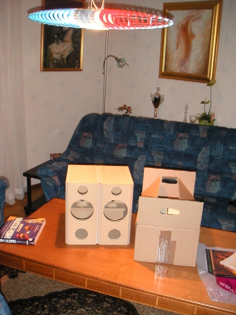

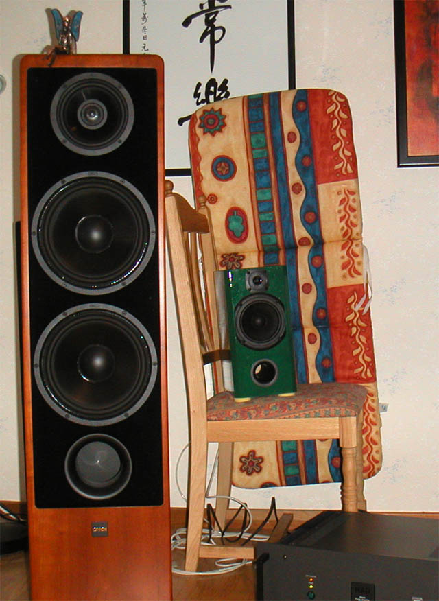

Around here I also decided to try building a pair of Ino piP from a kit. Didn't know anything about them and actually I had had quite a few heated debates with their designer on the forums before. Normally you have to go to Stockholm for a demo before buying them, but I found myself a 'pimp'. I needed a project and if nothing else, they could be used with the computer, they weren't more expensive than I could risk it ($4-500).
Not thinking that highly of them, I didn't do any major job in design, so I just painted them in a kind of british racing green, now also known as 'Nightlord Green'.
What happened was that which wasn't supposed to happen. My chin had to be picked up from the floor as these miniscule boxes played just as well as the twelve times more expensive Canton Digitals. Not straight away, but once the harshness of the tweeter had disappeared.
Used them side by side for a longer period and the Cantons turned more into audience for every day. No one visiting ever thought the small ones were playing though, they all "knew" it had to be the big ones.

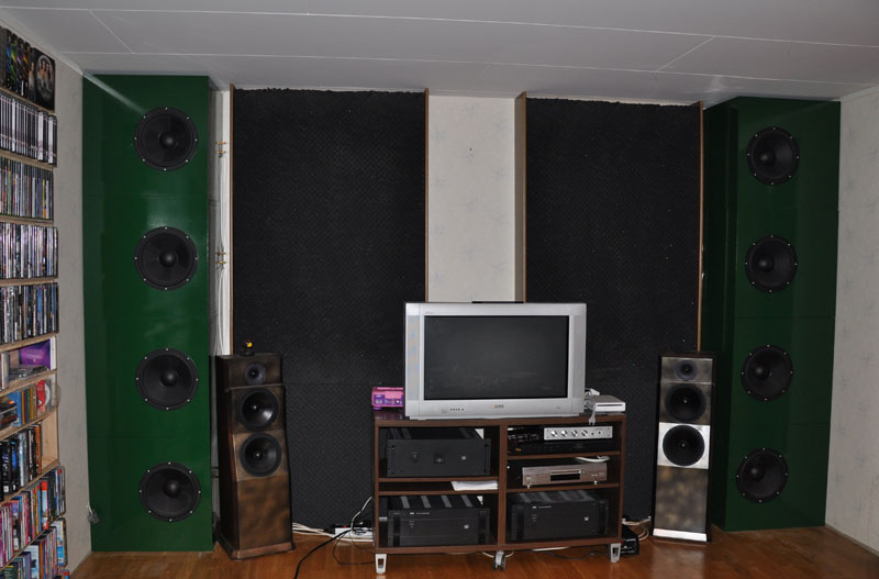

Got the garage cleaned out from a few things not supposed to be there, then I realized it wasn't one but two years the boxes had been sitting there so I went at them.
On the 29th the family was out so I rolled them in and then called Dad to help me with "the Big Lift" (that didn't turn out as tough as I'd figured).
The listening impression was good and positive - but the best win this time was that the two bass amps now ran with identical loads. Unstrained bass reproduction would probably a good way to put it.

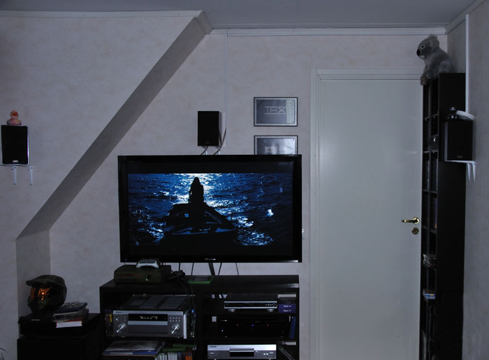

World financial crisis... and hit the plasma-TV department of Pioneer hard. The awaited 10th gen plasma won't go into production. As I can't see anything getting close to Pioneer in any foreseeable future I rushed to buy a 50" G9 while I still could.
The image is, as expected, sensational. And then it has to be run a few hundred hours before it can be calibrated... and then the autumn darkness will be here for better possibilities to do so. The most sensational is probably that it copes well with old VHS-tapes. Most flatsceens suck XXXXXXXXX on antenna signals.
If all goes well, this TV will get me through to the next paradigm shift... 3D-tv or videowall... whatever gets here first...

During the autumn I managed to get hold of an Infra plug-in card for the bass module crossover and then I finally got the ULF boosted so I finally found out what the basses can do. Extremely cool! Now the limitation is moved to the house... how much vibrations I dare give it before something breaks...
[Christmas 2011]
Strange rerun... The guy I bought the big kit from had bought a pair on unique pi60s in stone (later getting the official branding pi60s-s, as you can now order this form of cabinet directly from Ino Audio - same man making them of course) but due to financial reasons he had to part from them again. Having met the stone-man myself and learned what a thoroughly decent and infinitely likeable guy he is, I was a bit sad to see them embark onto the used market and possibly end up some unknown place where we never hear from again. It made me very uncomfortable. Didn't have a place to use them myself, but to put them in the office, so I decided to go for it and a snowy Christmas day we moved them to my office. Bought the whole kit too - a Rotel 1090 and a Holographic PRE-25 preamp. I think I sold stocks at a peak, so it didn't hurt as much as it could have. But this is a once-a-lifetime thing to do... something you just have to do... almost as if guided...
[Spring 2011]

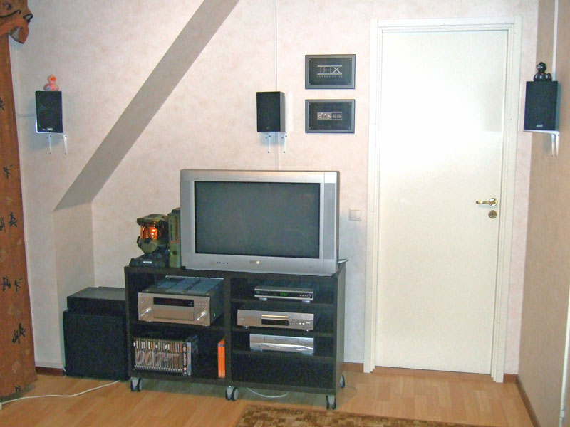

Had good success in adding to the home theatre in the TV room, first I found a single iP to run as center and then an additional two a2 to complete the surround to a 3+1+1+3 setup.
Borrowed an XTZ measurement kit and have measured and tuned the cr80s and Infra filters to get better curves. It's definitely not easy. Tried bringing in some insulation and putting here and there temporarily, but really saw no changes in the curves from that.

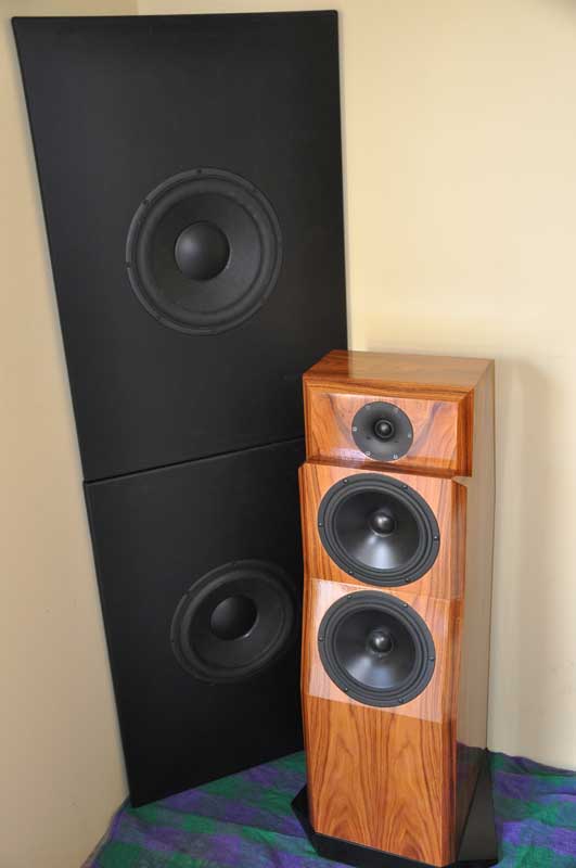

Being a full range model makes it a bit better to play with in the evenings when the kids are sleaping and flip the switch on the filter to fullrange fronts instead of top/bass.
...here's a pic before the pi60s-s was moved into position, so you can see the familiarities in the models...
Here's a little XTZ-measurement:
Top curve is pi60s-s alone, bottom curve is with bass modules handling sub-80Hz.
( If might be seen as bass heavy, but given the layout of my room, that's not how it's experienced by me, or anyone else having been here. )

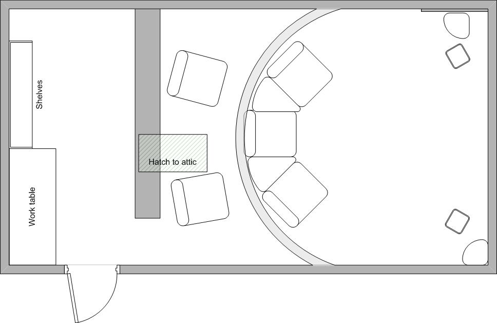

So... from March 11th and to the point of writing, I've been working on turning the space into a theatre.... with ups and downs... and I'm still far from done..
The basic floorplan for what I'm doing is like this:
The inner dimensions was 14 2/3 by 26 2/3 feet in total, but it's been decided/designed to just use 18 feet for the cinema and the rest for a sound-dampening back wall and storage/machinist room. Later changes to soundproofing will steal some of those dimensions as well (not done at time of writing).
