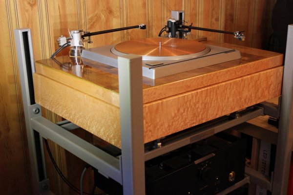

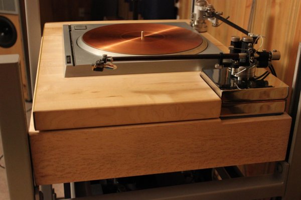

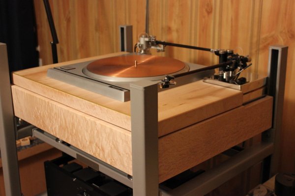

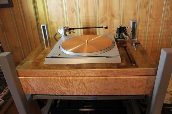

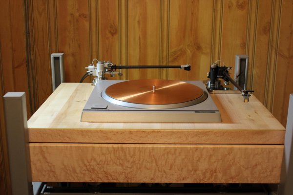

Very nice Sean. What wood is that for the burly plinth ? Looks like hard maple.
Thanks Christian. The trim is birdseye maple. The plinth is made out of 3 layers of 1.5" maple butcher block with layers of cork in between. Right arm board is 2 1" thick stainless steel plates with a layer of copper in between. I'm using Stillpoint Ultra SS for feet on an EquaRack stand.

Sean, I haven't really been following this thread but that is absolutely gorgeous! Who made the plinth? And what's up with the copper platter? And finally, are the Stillpoints underneath the top surface of the plinth or connected to the base where it interfaces with your rack?I decided to stain the top and put a clear coat on it this week. Looks a little better now.
View attachment 12023View attachment 12024View attachment 12025View attachment 12026View attachment 12027
Thanks Bill, I built the plinth a little over a year ago. I got some helpful advise from a friend that builds his own turntables and plinths for Technics, Garrard, and I think even Lenco's. He helped steer me in the right direction for what type of materials to build it out of. I also consulted with him on how I was going to build it. I just finally got around to putting a finish on it.
The platter mat is a Micro Seiki Cu-180. It's kind of rare but known to be a good match with the SP10. The Stillpoint's feet are under the plinth between the plinth and rack. You can't see them from the angle I took the pictures.
