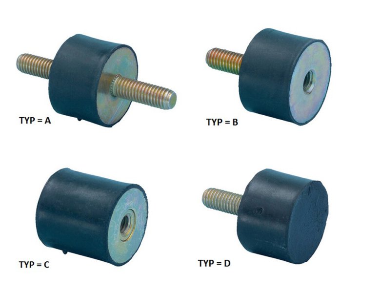

Sometimes it's enough to decouple tube sockets from the chassis using rubber mounts. The problem with this is that the tube socket moves downwards. If the hole in the topplate isn't large enough, the tube pins are too short.s-l1200 (6).jpg
Reactions: cal3713
Sometimes it's enough to decouple tube sockets from the chassis using rubber mounts. The problem with this is that the tube socket moves downwards. If the hole in the topplate isn't large enough, the tube pins are too short.View attachment 158746
Yeah, that's my problem, the chassis hole is smaller than my tube base unfortunately.
Then move them up?
I have thought about it. I'd have to fully rewire the sockets (they are also wider than the chassis hole) and have them bare out in the open floating above the chassis so it's not ideal. I have considered it though. I bought some parts to build my own homebrew vibration controlled socket extender "just like" the absob gel ones, so I'll see how that goes first.
