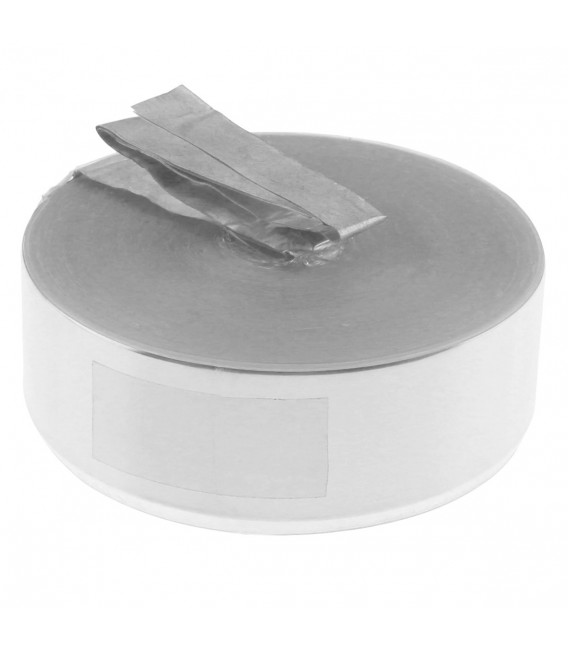

Buy a mundorf silverfoil coil awg 16 1.0mH thats enough for 2x 3.0m(4 foils) speakercable.
unwind silvercoil polish then paint against corrosion. move into cotton. take good plug and solder. then you promised one of the best speaker cables out there.
Cotton tube
Plug silver bananas
Or here silverfoil diy section

Stephan, thank you for the helpful suggestions and links to silver foil cables!
Reactions: DasguteOhr
