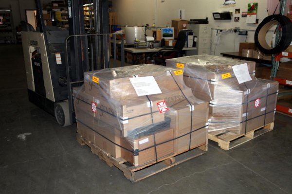

This year, he upgraded to (almost) a Genesis 1.2 (sans the twelve additional rear-firing 12-inch woofers). Almost every significant part except for the midrange ribbon and the cabinet was changed. It took two audio technicians, a woodworker, plus my personal supervision, and the customer himself making useful suggestions to do a perfect job. One excellent reason for keeping the original 20-year old cabinets is that the wood is gorgeous. It is difficult these days to find veneer wide enough to have such large, beautiful "cathedrals" in the veneer pattern these days. The cabinet itself was in excellent condition, never been moved and in a climate-controlled environment.
The Magnificent One is a huge system - and even the upgrade is substantial. This upgrade included all new tweeters, plus a new wire harness of my silver/copper/teflon wiring; twelve new 12-inch servo-controlled woofers (again plus completely new wiring); and the new 12-channel servo-controlled amplifier from the Dragon. A total shipped weight of almost 300kg (660lbs).

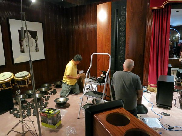

The upgrade process takes a minimum of two whole days with a couple of experienced technicians. By the the end of the first day, all the old drivers have been removed (on the floor to the left) and most of the 56 new tweeters already installed soldered to the new wire harness.

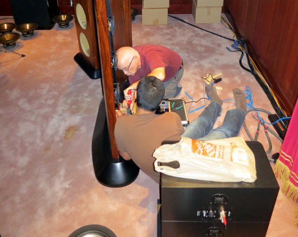

With a whole bundle of 12awg silver/copper wires, the soldering iron the techs brought with them the first day couldn't even hope to properly solder the tweeter harness to the Cardas rhodium/gold binding posts. So, it was the second day before we could continue. A big, fat soldering iron was found, and we put the midrange/tweeter panel back together.
We spent the rest of the morning also installing the 6 rear tweeters on the brackets.

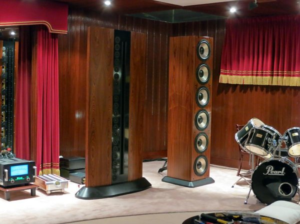

By late afternoon the second day, the system was re-built, the 12-channel Servo-Controlled bass Amplifier set-up so that I could listen to the system to make sure that it performed correctly. A couple of the owner's audiophile friends came over and we spent 4 hours spinning tunes. The local dealer who provided the manpower and service support was also there to help out with an experienced ear.
