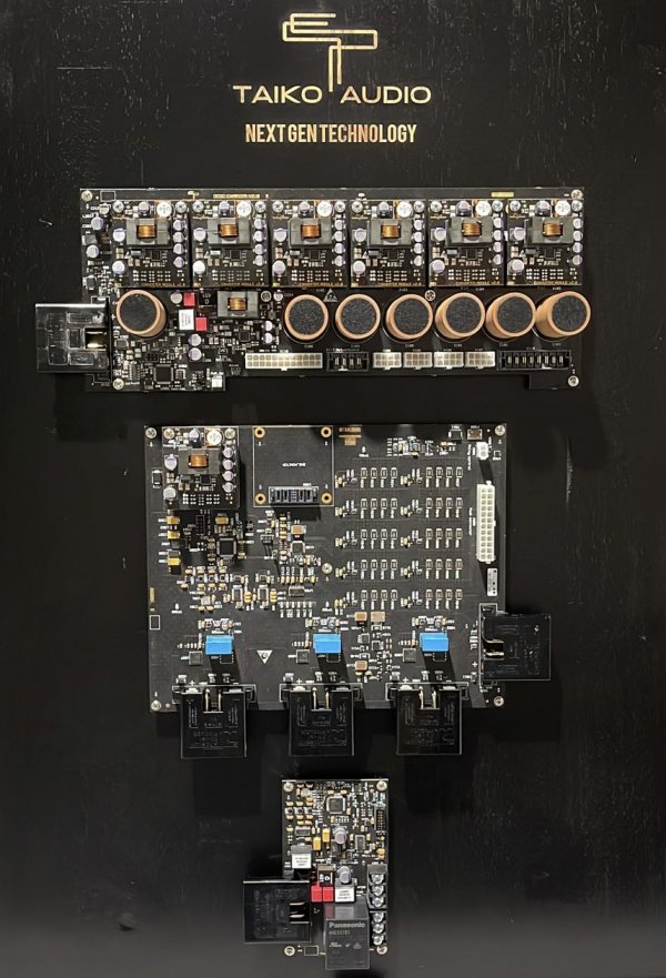

"Next Gen Technology
DC input power supply
The PCB is a DC input power supply enabling the usage of an external power supply. This utilizes GaN (Gallium Nitrate) FETs, can supply up to 11.500 watts, and run cool while doing it. This PCB would be placed inside the Extreme Music Server."
This new PCB inside the Extreme can be powered by the upcoming BPS (or maybe as a less expensive alternative by an unregulated LPS?)
Matt

Sorry for the confusion I generated from my post. To be clear, I don't know that the DC board from the full BPS system will be offered by Taiko as an upgrade to owners who decide not to buy one of the BPS options.
The function of the three boards making up the BPS control sections is explained in post #10,583. I am sure that some time after that Emile mentioned that the DC board from the BPS represents an improved level of performance over the current Extreme DC board.
I used this example (clumsily) in my post about the current Extreme power supply being very, very good but not "the best in the world" and indeed, not the latest state of the art.
IIUC (and if not happy to be corrected) the uppermost board is the new internal DC to DC power supply of the "new" Extreme. This board has basically nothing to do with the new BPS, it must be powered by a certain range of DC power only.
The other two boards belong to the new BPS.
The new internal DC board can be powered by either the new BPS (for highest SQ) or by another suitable PS (which might be less expensive). Maybe it is possible to power it with the power supply of the current Extreme as @Steve Williams mentioned.

I'll disagree with you, Matt.
From page 530, post 10,583:
"The top PCB is a DC input powersupply enabling the useage of an external powersupply. This utilises GaN (Gallium Nitrate) Fets, can supply up to 11.500 watts and run cool while doing it. Obviously this is overkill, but overkill is sortoff our thing I guess.
The middle PCB is a BMS (Battery Management System), this allows the usage of a battery pack to power the top DC input powersupply. Why did we go through the trouble of designing this while a BMS is widely available and/or included in virtually every battery pack? Because they sound bad and severely degrade battery supply audio performance to below an elaborate high-end AC-DC supply, that is now no longer the case.
The bottom PCB is a battery charger / controller with a remote control interface controlling the BMS."
(bolded, italicized text mine)
The second paragraph explains that the top board shown -- DC input power supply board -- is allowed to be powered by a battery pack by the second board -- Battery Management System -- which works in conjunction with the bottom board -- battery charger/controller.
So I take this explanation to be showing the three board comprising the Battery Power System (BPS). Nothing in this says the DC input power supply board could not work on its own (without BPS) if given a suitable DC source, such as a linear power supply. However from the post is written it at least strongly points to all three being necessary parts of the full BPS system.

Steve,
the uppermost board is basically similar to the Taiko DIY ATX DC to DC board but it is of much higher quality and specs for the Extreme.
This board is as mentioned "a DC input powersupply enabling the useage of an external powersupply". It must be powered by an external power supply which outputs DC into it.
Now you can basically feed it with DC from the BPS for highest SQ or from another DC output PS.
In the case of the Taiko ATX DIY PS it is the advise to feed it with an unregulated LPS.
Maybe @Taiko Audio helps to clarify :)

However, Emile himself said in post 10.619 on page 531, that feeding the DC PCB with an external LPS, even if it was the one that is currently inside the Extreme, would not produce a great improvement.
There is no new AC-DC powersupply for the Extreme.
The new DC-DC board has been specifically designed to work with the BMS/BPS as a 2 box solution. We are currently also designing a version to be able to create a 1 box BPS powered Extreme.
The BMS/BPS is not comparable to other battery solutions which are on the market today, as far as Im aware.
Overall even a slight degradation.
