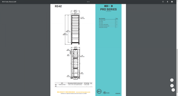

Nobody said this was going to be cheap....ordered the equipment racks. I'm going to split up the amplifiers with 4 per cabinet , 2 6 channel and 2 2 channel per.....
The 3415 Bass units with 8 15 inch drivers will be bridged using 16 of the 24 channels of the 6 channel amps. That will leave me with 8 channels...4 for the 2 subs, 4 for the 4 surrounds. The 8 channels using the 2 channel amps...6 channels will drive the horn cabinets, 2 channels for the front center.... Using all 32 channels. 6 x200w horns =1200w ,1 center = 1500w, 4 surrounds = 2400w, 2 subs x 1200w = 2400w, 8 bass drivers x 1200w = 9600w for a total of 17,100 watts...but will never get close to that output.
I also ordered 2 pair of QSC SR-1290's for the mid ,rear channels and 1 single for the front center channel. Cabinet maker comes Tuesday.
