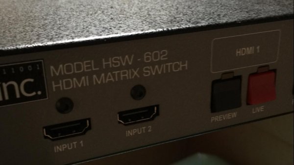

I received the USL HSW 602 digital interface today. Hopefully this will give me 8 digital channels a long with the Oppo analog channels. I also have decided to run 4 psycho acoustic channels in the place of a mtm center channel. I use the same configuration in my other system with great clarity and resolution. So I picked up another pair of Fulton FMI 100's to use for the circuit,with a 2 way Mission bookshelf pair. The Pyscho pairs will be powered using a upgraded Accuphase P300 amplifier.

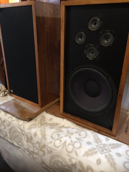

As side note I now have 4 Fulton FMI 100's and the plan is to use them as RR & LR and PsychR(RF) & PsychL(LF) channels. For a 4 channel setup I needed four identical speakers and now I have them. I will setup my 2 Crown CX844 decks and will be able to play my quad tape collection. I can use my C200 preamp with my Sony quad interface or acquire a Marantz 4400...lots of ways to go.
The Fultons were the first high end speakers I ever heard. They can completely disappear and that's what I want. The 100's use a RTR 10 inch woofer and 4 Peerless MT225 super tweeters. Another interesting thing about the crossover in these is that Fulton used 2 SS581 Ford starter relays in the circuit. I'm not getting any younger..so finish it now so I might be able to enjoy it for as long as I'm around.

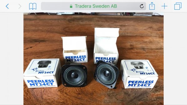

I was lucky enough to find 4 Peerless MT24CT tweeters. They are OEM to the Fulton speakers and really hard to find.

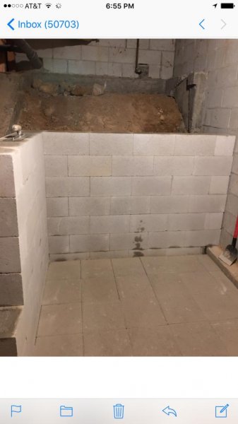

Equipment Room / Amplifiers

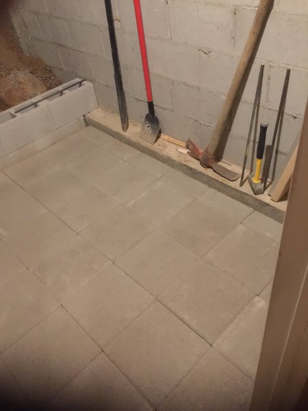

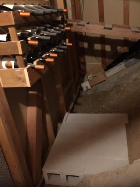

There's something about audio that makes one do extra things. I was worried about space for my amplifiers and the noise they would produce in my main room. I also wanted to enlarge my modest wine cellar.
The solution was to enlarge a small area in the cellar area just off of the home theater area. A little excavation and muscle was needed but so far,so good. I wanted to remove more of the mound on the back wall,but big granite rocks can be a problem and dynamite would just not be a good idea.
The space will be about 40 sq ft and be plenty for 2 equipment racks and a 50 bottle metal wine rack. I should have this completed this weekend and will post more photos. After this a electrician puts in the sub panel. Lot's of fun, plus not seeing the equipment and having a quiet theater area I think this is worth it.

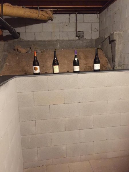

The block wall will be tied into the foundation wall with rebar.The blocks serve as the form and have rebar in every hole. I'll use a rhyolite cement slurry to fill the block.The back wall where the granite rock is will be 4 feet high and It will be back filled with some of the excavated dirt. In total about 2 and half tons of dirt was removed. One of my workers left town on the Greyhound bus after the job...he had enough and was going home.
The room stays at about 60 degrees year round. I'll put a fan in to circulate air and have to use some enclosed pro audio style racks. The sub panel will be about 80 amps and i'll have the Oppo and preamps in the main room.
Thought I would post a photo of how the wall is tied into the Foundation wall. The half inch rebar is set into a drilled hole and then the block is notched to fit over the rebar.
Came out well...just need to fill some joints and put the cap on. Found a nice set of wine racks....should fit about 300 bottles.

I put a black limestone cap on to finish the wall. A few further details to do and then schedule a electrician for the sub panel. The wall was quite a project,22 bags of 2/3 thirds lightweight concrete. I figured the wall tips the scales @ +3500 pounds.
