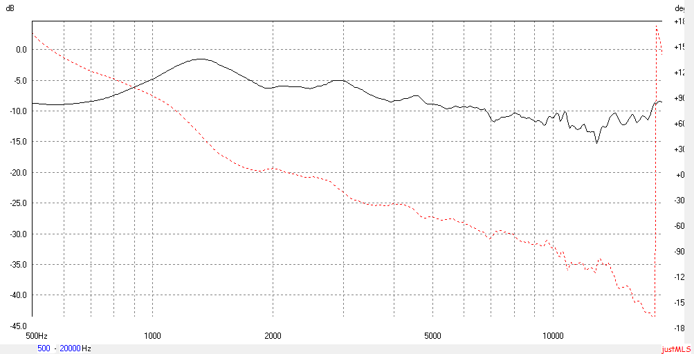

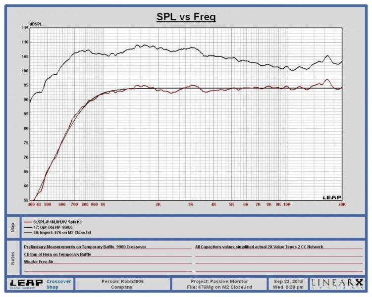

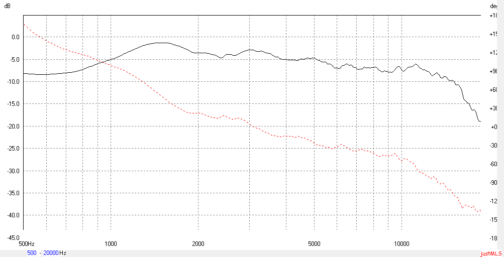

Depends on the actual diaphragm construction and the woofer sensitivity. The Mylar surrounds don't have the benefit of the secondary resonance used in a metal surround to help extend the last octave so they roll off quicker. Using a passive network with 98 dB woofers makes it difficult to not have the roll off be an issue. You don't have as much leeway as with a 94/95 dB woofer.
Here are Sebackman's measurements of a Truextant mylar vs a Ti SL. Mine are a 476Mg SL you can clearly see the trend, where the rising HF in the last octave makes use of a passive network easier.
Rob :)

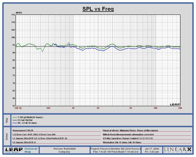

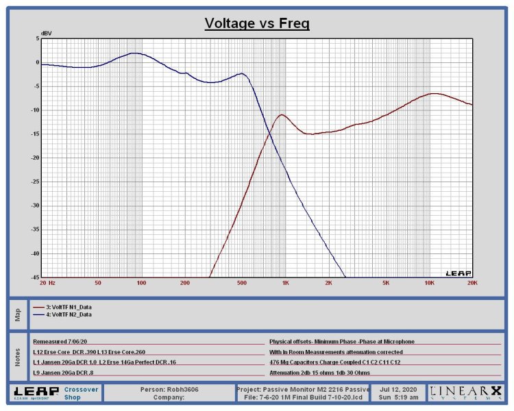

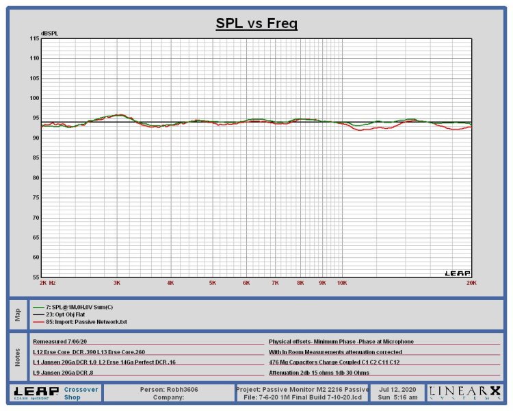

I failed to take into account the unusually high efficiency of the Altecs. @Robh3606, do you have any thoughts about this?
Hello Duke
Looking at the SL measurement which also is rising last octave very similar to the 476 Mg and my own voltage drives it looks like there is enough there for the SL. The Be with no secondary resonance? Once they roll off on the waveguide it goes quick. I have Be drivers 435Be's and SL's are not slouches so I don't see the obsession with Be when what you need is what works. The 2216's are 95 dB, the voltage drive where if you kept the curve and used less attenuation on the driver/waveguide combo you have some headroom. -6db @ 10k.
I have friend running a passive M2 with 2430K. Looking at the 4367 white paper the 2430K should work as well but?
It's a real balancing act, it's on the edge @ 98 dB depends on what his goals are. Mine was as "flat" and as "close" as I could get it compared to a real M2 system. I am running with attenuation so that would help and I like a flatter curve on axis others may want things more rolled off so even it it can work he may not like it. So?
Here is voltage drive and the as designed as built measurement the green is the LEAP sim the red is the actual system. You can see some drop off above 10K on the finished system. I run the system with about 1 dB of attenuation per the LEAP sim.
Rob :)
Yes, as described in that JBL Tech Note report you had me read, the secondary resonance of those metal surrounds generate the energy which can be used with a passive RC filter to flatten and extend HF response. And does this aquaplas diaphragm have the metal surrounds?
