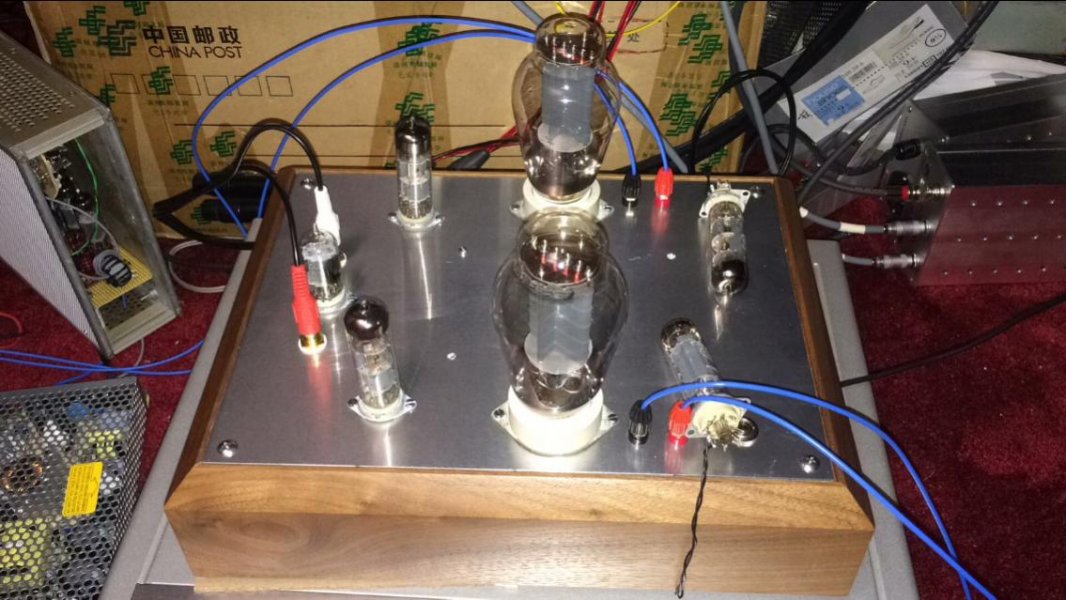

SET Zotl on a pair of Tannoy nfm-8 dmt. Light weight , ca. 3Kg, build-in 12V SMPS. The amp is very compact this way. It's strength is in the 3d detail and bass definition (nice for organ concertos).
