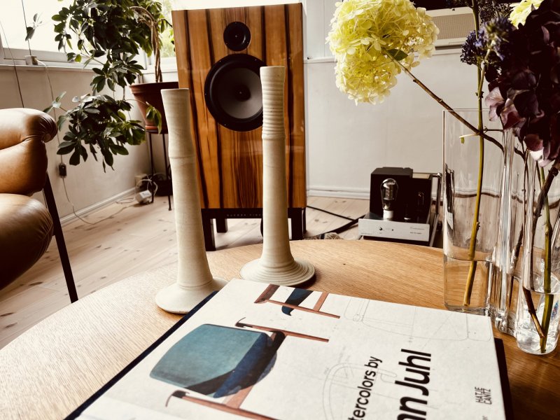

Both chokes in place. Leif told med to give them 50 hours before serious listening. In the meantime the Hørning OPTs are getting prepared.
Looks like about 2-2.5 feet? 60-75cm? I recall you like a lot of space for the Devores...1-1.2m'ish?
BTW, that closeup image is a well taken shot. Was that a phone or a camera?
Reactions: crosswind
Try the Devores with a straight on position. How far are they from that front wall
Will do. They are 110 cm from the front wall and the left speaker 120 cm from the left wall. (All measured from center/front of drivers) I am planning of moving them 50 cm away from the left wall but I am unable to move them much more out from the front wall because of the listening position being stuck. The sofa can’t move further aft as you can se in the pic.
Reactions: Lagonda
ok. if you straighten them you can get them slightly in towards each other as compared to when toed in.
