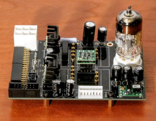

https://vtvamplifier.com/product/vtv-amplifier-custom-vacuum-tube-input-buffer-new/

"I found that the Eigentakt was not only powerful enough to drive the A1s -- it sounded as good as the Constellations. As I wrote in my review, “almost nothing about the A1s’ sound had changed -- the tonal balance was the same, the highs were just as extended and the midrange just as pure, voices were equally robust, bass just as extended, and the soundstaging and imaging were exactly as before.” What’s more, I also thought that if there were any differences in the sounds, they “were at best slight and, surprisingly, favored the Purifi.” I played “Hope Is a Dangerous Thing for a Woman Like Me to Have -- But I Have It,” from Lana Del Rey’s Norman Fucking Rockwell! (16-bit/44.1kHz FLAC, Interscope). As I also said in the review, “the subtle sounds of her lips moving as she sings softly into the microphone were more apparent through the Purifi.” Ever since the arrival of the Revelation Taurus monos, I’ve loved their combination of smoothness, detail, and effortlessness -- for the Eigentakt to turn in the same performance, at a fraction of the price, was incredible. I was impressed. Granted, if I’d needed more power than the Eigentakt could provide, the Constellations would have easily walked away with the prize -- but in this first test, and within the Eigentakt’s power limitations, its sound quality had proved extraordinary."
The above is a quote from:
https://www.soundstagehifi.com/index.php/opinion/1420-purifi-audios-pint-sized-powerhouses
If you think the Constellation mono blocks he is referring to have no hollow sound.....then indeed....the stock Evaluation module amp mentioned in the above review (very similar to the $900 basic Purifi amp from VTV) has no "hollow sound".
Most class D amps until about 3 years ago had some of what you describe. You can change the sound of class D any number of ways....it is not just the module but every single thing you do. I can make a Purifi amp sound as hollow as you like.....or not hollow....warm and fuzzy or super analytical. This game is infinite. No module by itself is going to make great sound. The stock evaluator board amp or the basic VTV amp sound incredible for the money.......but when modded......that is another whole level better. Then there will be better circuits down the road. There is no end for this. Class A has been done at the serious level since the early 80s......class D has been done at the serious level for about 3 years.....there is a lot more coming.....yet these relatively inexpensive Purifi or NC1200 modded things are simply out of this world......but out of this cosmos is coming.
Some Class A amps are actually warmer than real, especially tube amps. Does any class D have as much "meat on the bones" as these warm sounding tube and Pass labs amps? I personally want my music to sound as rich and meaty as it was live.....not any more. So I design for as little signature as possible. However, if you have a lean sounding system....then you need a warm sounding thang in there to balance it out. Of course, you can use warmer Cardas, etc. cables to balance things out too. One thing is for certain. The distortion of class D amps is going down, down and down.......revealing more information......this is good. There will be plenty of class D amps in the future to pic from....some will even be designed to sound warm. In fact, VTV has just released a tube front end for the Purifi and Ncore modules to give you that WARM TUBE loveliness.

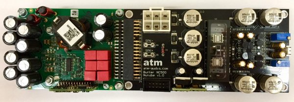

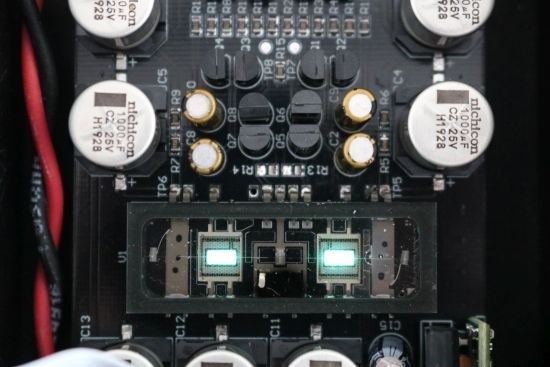

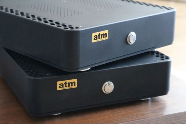

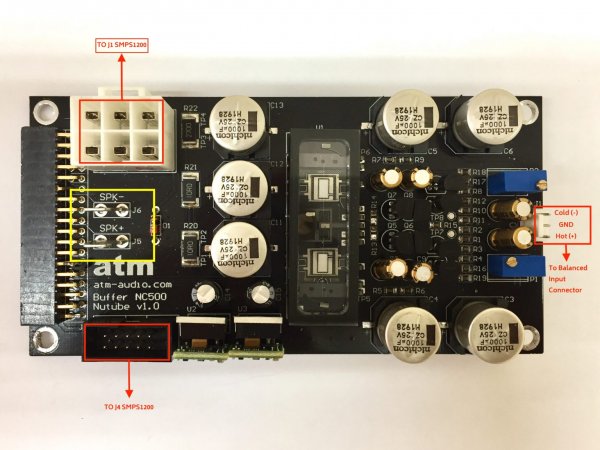

This ATM Audio RPM-700 monoblock is interesting.
This review is worth reading :
https://www.hifi-advice.com/blog/re...plifier-with-korg-nutube-triode-input-buffer/
It was said to resemble class A or A/B poweramps.
Yes, the chassis looks excellent but the Hypex 500 module and switching psu are the usual varieties.
Can the superior performance due to ATM's proprietary input circuit board ans the unusual Korg Nutube Triode Buffer module?

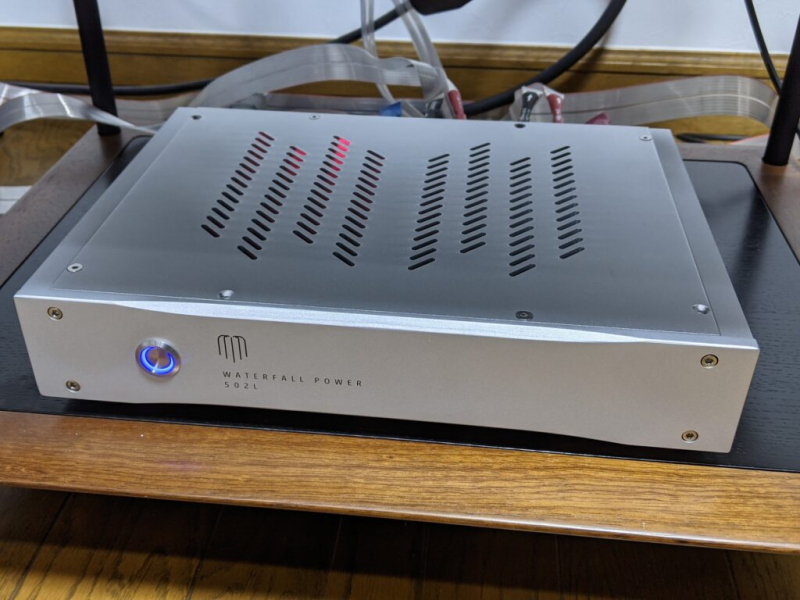

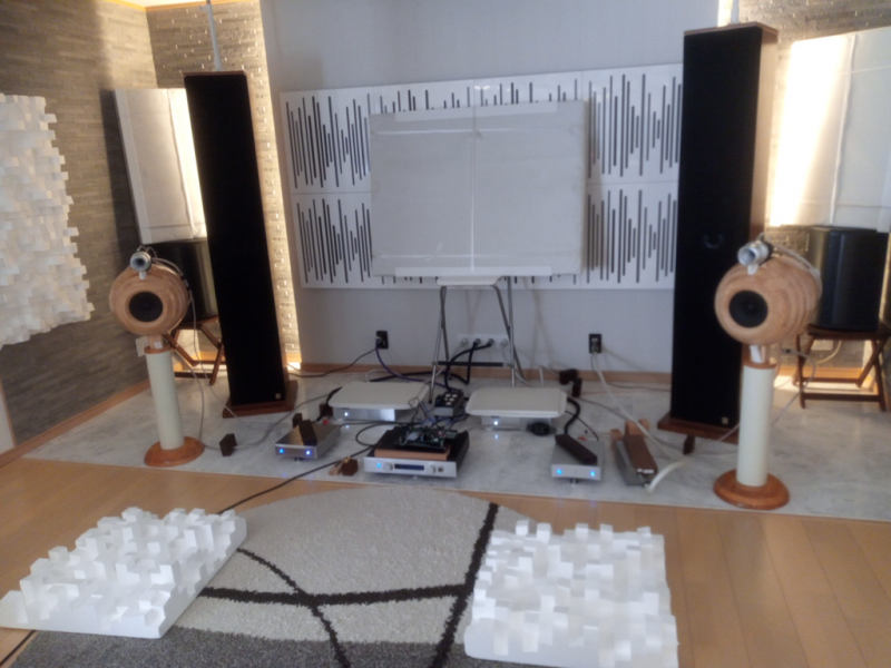

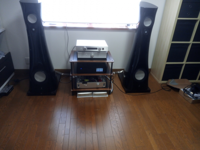

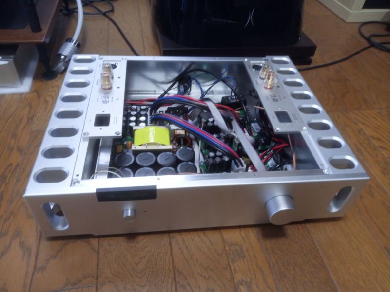

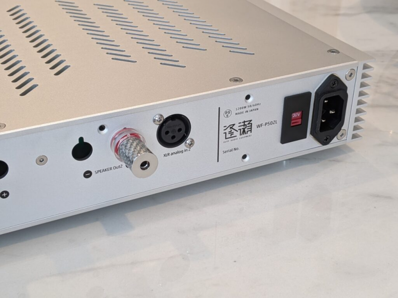

I would like to introduce another NCore amplifier, Ause Audio Equipment in Japan.
They had NC500 monoblock WF-P500, with their original noise reduction technology.
https://ause-audio.com/?page_id=1321
Unfortunately this nice model has been discontinued, however new budget NC500 model, WF-P502L is coming:
I tried it yesterday at their place, this is the best NC500 power amp I have ever listened especially detailed tonality.
I also listened NC1200 trial version which sounds superior at mid range and base with better attack.
They also have another unique product, WATERFALL Integrated 250, AK4497 DAC + NC250 power amp. This model has four working modes: DAC mode, Power amp mode, Integrated mode and outer preamp mode.
https://ause-audio.com/?page_id=1272
I realized at discussing with them that they have very original and unique idea. For example, they are planing a new product called "Digital Reconstructor", a sort of DDC but this feature has never seen before. I will report it in another thread.
Reactions: Matias and CKKeung
