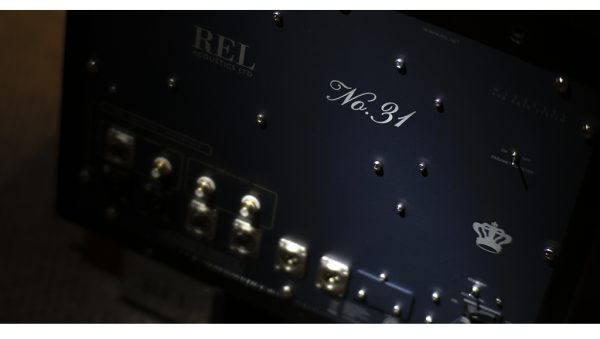

I had ordered pair of Rel 31 to replace two 18 inch sealed subwoofers of Scaena 3.2 while keeping main tower of it.
I also considered Rel 32 but Rel 31 will be enough in my listening room.
Also it shall be crossed at 120 hz so smaller woofer may be better in my situation.
After I get it a week from now, I will report my findings.
