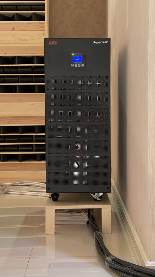

I had some ac distributors, ac filters, UPS, AVR … all of them were not good. ABB switzerland is very good in AC regeneration industry , very high quality parts, very low distortion but the ABB 20KVA never sounded good.
I have spent many times for this problem but did not find the proper solution.
ABB low distortion 20KVA UPS
