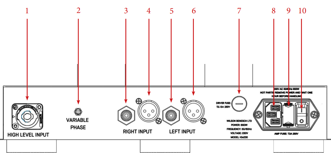

Hello,
I need your help, My setup includes CH Precision L10 preamp, dual CH Precision M1.1 power amplifiers, Stenheim loudspeakers and Wilson Benesch IGX subwoofer.
I want to add additional Wilson Benesch IGX subwoofer to my setup but unfortunately there is not enough XLR outputs in the CH L10.
I checked another alternative such as VAC, Dartzeel, Robert Koda and soluo but I did not find more than two XLR outputs in their preamp.
any suggestions?
I read about external crossover such as Wilson ActiveXO but I’m not sure that this is the perfect option.
you’re amps have a balanced input and output/ bypass
You can run a balanced cable out to each sub from each channel

Can't you use the M1.1 amplifier XLR balanced analog output (pass-through for amplifier daisy-chaining) ? I will free one of your preamplifier XLR outputs.

I don't understand. You don't have to use XLR for the subwoofer.
You could use XLR from L10 to M1.1 and then use RCA from L10 to the second Wilson Benesch.
The likelihood of the RCA to your subwoofer sounding inferior because you're not using XLR is very low.

Just add another Wilson Benesch IGX subwoofer following Jim Smith advice. If possible get someone knowledgeable to set it up or at less read the "Get Better Sound". An RTA or even a sound meter can help.
The WB IGX has XLR, RCA and high level inputs (like REL). You can easily find high level interconnector with long leads. This is then connected to the speaker terminals of the amplifier. Or you can use a pair of XLR from the preamp and a pair of XLR pass through from the Amp as Elliot suggested.
I set up 4 WB IGX for a person who used the high level input on all 4 of them. This worked fine.

I use 2 WB subs, and feed the left sub the left channel signal, and the right, the right, i.e. 1 XLR to each (or RCA in my case). Not sure why you can't do this?
Alternatively, as others have said, use the high level (i.e. taken from the speaker taps on the power amps) to the iGX. This is WB's preferred method of hooking up their subs.

As a user of 1 Wilson Benesch sub (the original Torus), currently providing foundation to my Magico S1 MK2, I wonder what a second sub adds in your opinion.
Also, I use the high level input, dire try connected to the speaker binding post of my amp.
That's indeed the way WB advise to use their sub.
Alternatively, like other mentioned before, you can used the XLR path through of your M1.1.
This way, you only use 1 of the 4 output connector of each channel of your L10, which is the best way to go.
