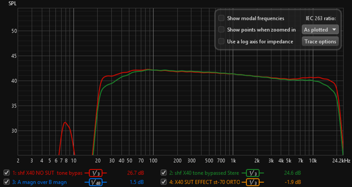

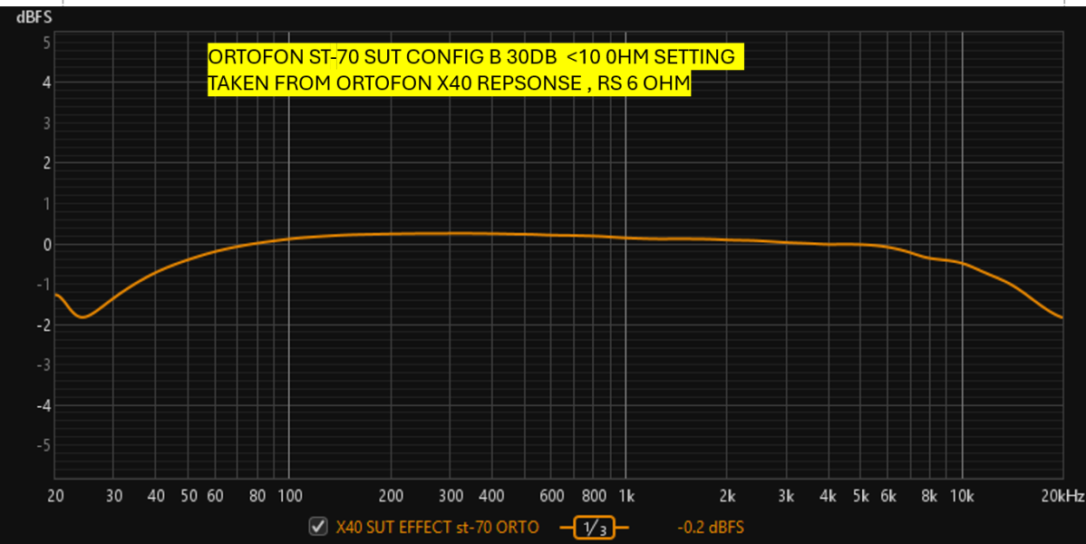

Ortofon ST-70 configuration B 30db gain for cartridges less than 10ohm.
This is the isolated SUT response with Ortofon X40 which has 6 ohm internal resistance....
does NOT seem like an ideal match to me. hopefully config A 24db gain performs better.
The data giving the SUT response in from the difference with and without a SUT. Since I know form other teste the load in the MC stage does not alter the frequency response, the difference represents the true SUT response with the given cartridge1762183082399.png
