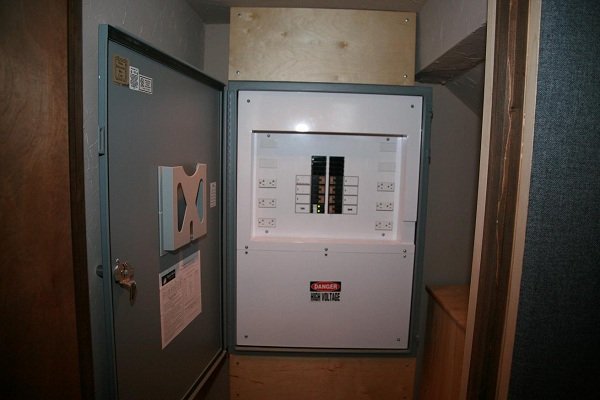

Below is quote from opus111 in another thread it might shed some light on your problem. I have the Mytek in my system and have not experienced any of the issues you describe.
"the Mytek guys either don't know about common-mode conducted mains noise or have engineered their design cleverly to avoid it. They're using an off-the-shelf mains filter block (chassis mounted, top right) and then a toroidal transformer. The upshot of this is plenty of coupling of external mains noise to the internal circuit ground. Using an standard filter 'brick' means there are going to be Y-caps (mains to earth) and so the filtering quality depends on how clean the provided mains earth is."
"PS I'm conjecturing here but probably Bruce already has industrial strength mains cleaning technology installed so won't be worried if kit doesn't provide its own filtering. The average domestic user hasn't heavily invested in mains purification kit."

here's mine....
