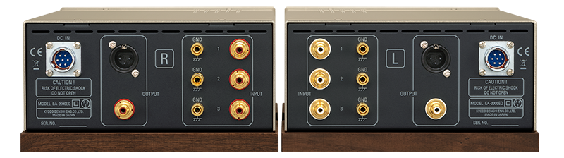

some details about the EA-2000:
The main EQ unit comes in 2 boxes, one for every channel. Full Tube MM stage, 3 RCA inputs, XLR & RCA outputs, 3 curves.

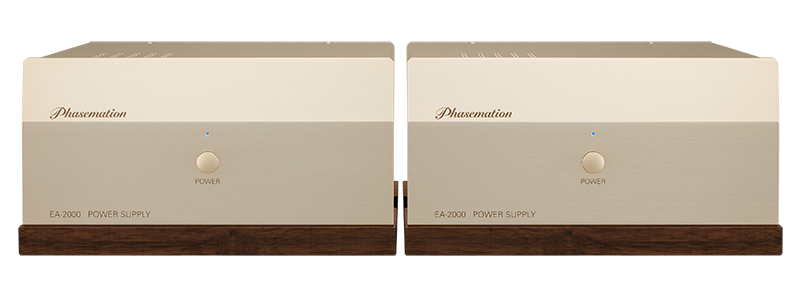

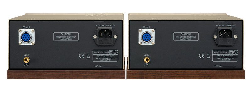

power is provided from 2 full tube PSU , using 5U4G as rectifier.

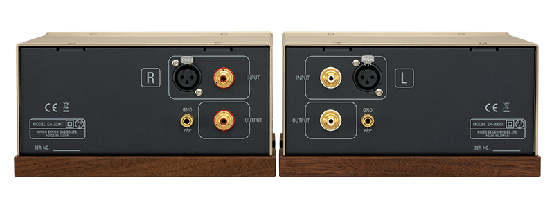

To get the necessary Gain for MC carts, you need a separate Step Up per input. The EA-2000 comes as standard with 1x EA-2000 step up, which is in principle the
standard T-2000 step up, using the same RCA connector as the EQ unit.
The EA-2000 / T-2000 provides XLR or RCA inputs.
Phasemation ships the EA-2000 with a RCA wire and some ground wires. The shipped RCA is just ok, but I do prefer other cables between step up and MM unit.
Technical details can be seen here:

Isn't it limiting that the EA-2000 has only one gain/impedance setting in its step-up?
Phasemation sees the EA-2000 mainly as 3 input MM Phonostage.
Every cartridge should have the best matching Step Up, many cartridge maker do offer a matching step up as well.
The EA-2000 will be an adequate load for them.
As standard the EA-2000 is shipped with 1x T-2000 step up,
which will work with carts from 1,5ohm to 40ohm, best between 3 to 6ohm DC resistance .
Their goal for the Phasemation step ups is, that on the one side the Matsudaira type of carts
and on the other side, that the Denon DL 103 cart will work properly.
Coming from their white paper, the most MC carts will work fine with EA-2000/T-2000.
But clearly the sweet spot of performance of T-2000 is 3 to 6ohm, I love to listen to Koetsu carts with T-2000.
To host my Phasemation or MSL / TechDAS Carts aside to the Koetsu carts, a second T-2000 is in place.
I am a big fanboy of the Soundsmith cartridges, unfortunately the T-2000 will not work in a good way with the fixed coils carts.
To get the best match, I ordered for the EA-2000 a 1:10 Consolidated Audio copper step up,
Which will be a real good match to my Hyperion cartridge.
Maybe I will buy sooner or later again a Kondo SFZ Step up for the very low resistance carts.
At least my goal is, that I can connect every single cart in my collection with a matching step up .
My experience with build in step ups is always, that this step ups are too much a kind of compromise and do limit the performance of the total phono stage (as with my Allnic H-7000v)

Phasemation do sell their step ups as seperate units too, The EA-1200 step up is the same, as the seperate T-1000, which retails for around 3500,- in Europe. Compared to other seperate step ups in this league, like Lyra or the consolidated Audio, the T-1000 is more flexible in the use of carts and sounds more full bodied than the others.But assembled with EA-1200 the tonality becomes more neutral. EA-2000 balance is a little bit more warm, but overall a different and higher level.
EA-1200 is (at least for me) still the best buy in their portfolio, specially as you can improve it step by step over the time.
Phasemation will introduce the second PSU unit soon (similar to EA-1000 before) , which will bring the EA-1200 more close to EA-2000.
As I own the T-2000 step up for a longer time, I can promise, that this is an improvement as well .
The big bonus on EA-1200 versus EA-2000 is, that you can connect 3 carts to the integrated T-1000 step up.
For the EA-2000 you need 3 seperate step ups.
In my case 2x T-2000 plus Lyra plus Consolidated Audio as options (more to come)
