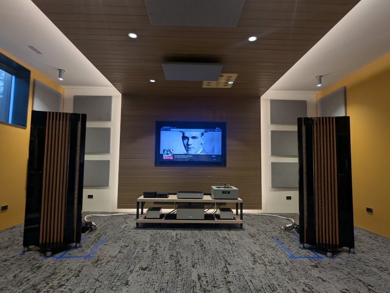

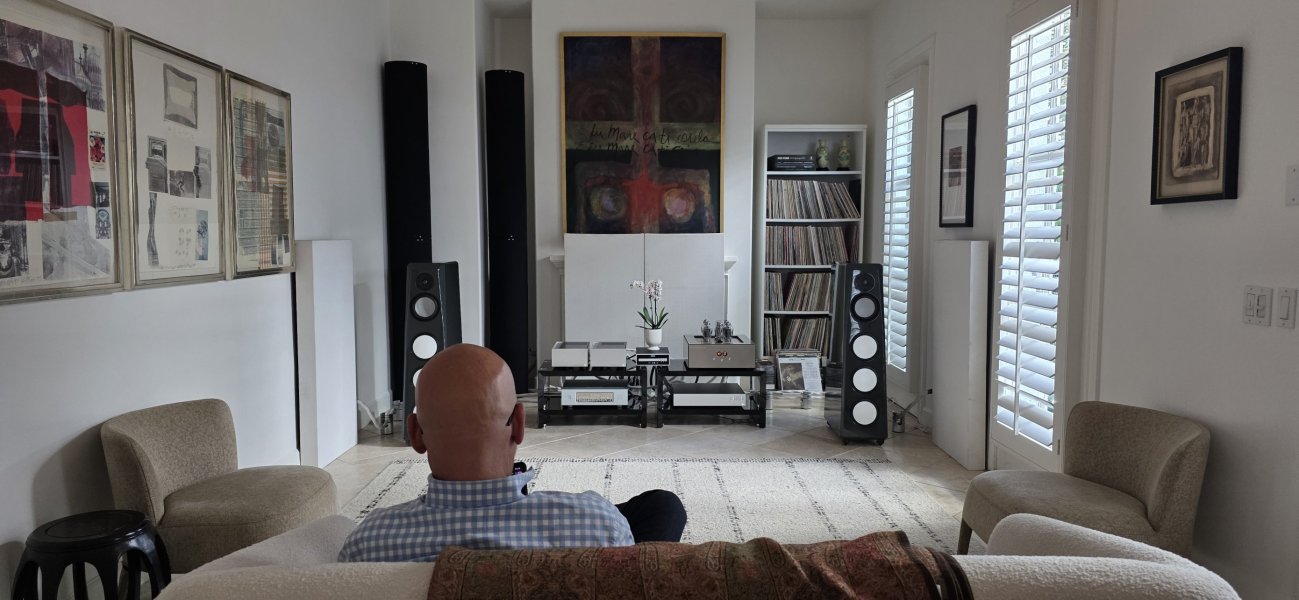

Agree on the preference for sidewall placement whenever possible, as many audiophiles overlook this crucial aspect of creating the best soundstage and minimizing smearing.
Below are two systems using low racks where a higher rack placement can create havoc with the soundstage and overall resolution due to smearing. In the first system, we created a custom Folgenhaus rack that was especially wide and maintained a very low profile for the gear placed between the Alsyvox ribbons. This worked out well with little to no effect on his soundstage and central image, and a significant improvement over his formerly much higher equipment shelf.
Next is my system, which utilizes a similarly low-Raidho rack. I was able to keep the equipment below the Von Schweikert tweeters. Again, good results. If the room allowed for it, I would prefer a sidewall placement for best results.
More audiophiles should consider this configuration over the tall, multi-shelf equipment stands commonly in use.

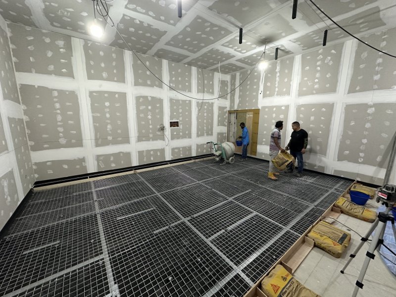

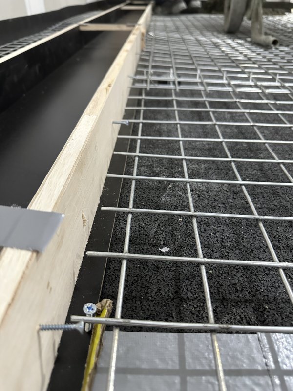

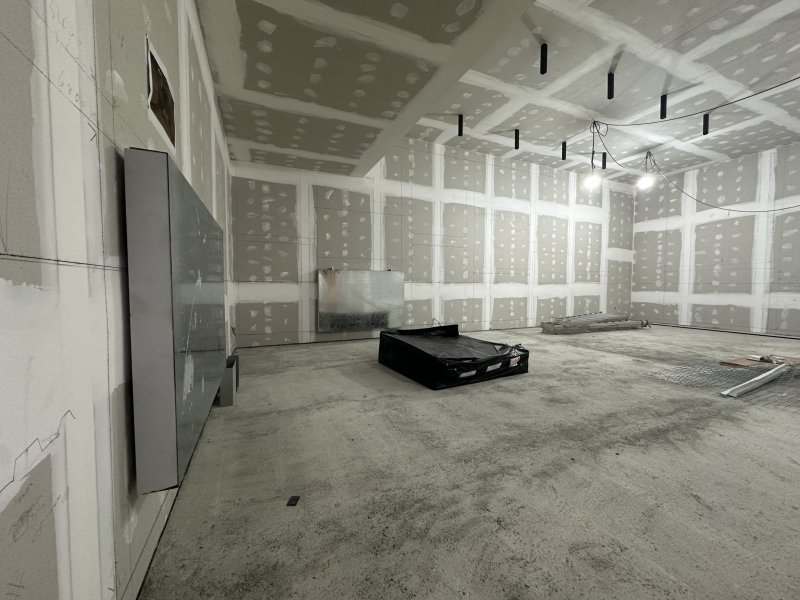

The front half of my listening room has been screeded with steel mesh, being readied for concrete to be poured. Closed-cell foam is inserted as a perimeter wrap, decoupling the screeded concrete floor from the walls.
The thin black sheet below the steel lattice is composed of material similar to the chopped rubber mat seen in children's playgrounds, providing stiff but resilient constrained-layer damped isolation between the surface and Mother Earth's ground below via the house's foundations.
The rear half of the room will feature a floating floor (not yet built), decoupled and isolated using heavy-duty springs on elastomer bushings. Look out for more photos in coming weeks!
...Oh man, that is primo. You need to get one of those "thumpers" from Dune to call the sand-worms, to test the isolation when finished. I would like to attend the test, please.
The front half of my listening room has been screeded with steel mesh, being readied for concrete to be poured. The thin black sheet below the steel lattice is composed of material similar to the chopped rubber mat seen in children's playgrounds, providing stiff but resilient constrained-layer damped isolation between the surface and the ground below.
Next level as usual:)
Is the idea to prevent vibrations both in and out of the space or are there very low bass absorbtion intentions as well. Is the intent of adjacent slab floated on springs to prevent excitation from speaker.on that part of the floor
I imagine this will also make your equipment rack, footers etc. perform better
Bravo!

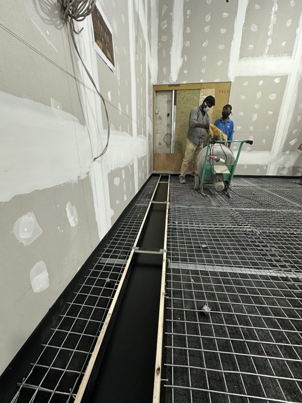

AC Power Cable - delivery system
Initially, I was trying to visualize the anticipated locations of all of my audio components and speakers, in preparation for PVC channels which would deliver the "snakes" through the floor screeding and ultimately emerge upwards from the ground. Without really knowing exactly where the component racks, amplifier stands and powered loudspeakers would finally end up, given the inevitability of the positioning tweaks both acoustically and visually, it became a very difficult high-stake guessing game which caused me to hesitate with nervousness.
The solution to my dilemma was a simple but brilliant one, derived through a flash of inspiration, essentially a back to basics reexamination. Why not just let relax the multiple bundles of thick, stiff, and heavy power cables channel freely through a hidden (not ferrous/metallic) conduit located underneath the outcrop of the P23 QRDs on the front wall, and let them emerge wherever they're needed laterally?
The gutter channel will be painted black, so it’ll be invisible under the shadows of the P23 QRDs. They’ll also have two longitudinal flaps, one solid and the other in a “brush” finish.
Front to back, the AC cables will simply be terminated with enough length to cover the required distance to wherever they’re needed.

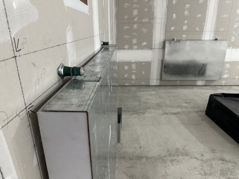

Both the front and back sections of the floor has been screeded, and the VPR metal plate bass traps are being installed!
For those curious about VPR bass traps, here’s a discussion thread on the devices:
Reactions: christoph
The mounting clips are sourced from providers of professional acoustics components, the foam is Basotech from BASF, and the steel plates are (galvanized) generics cut and shaped with mechanical tools. Essentially, they’re RPG Modex plates, without the fancy branding, packaging and premium prices. With over 80 pieces to install inside the room, it's the only (relatively) affordable way!
The mounting clips are sourced from providers of professional acoustics components, the foam is Basotech from BASF, and the steel plates are generic (galvanized), but cut and shaped with mechanical tools. Essentially, they’re RPG Modex plates, without the fancy branding and packaging.
I thought the front plate was glued to the foam and floated free in a frame .. yours seems to rely on the resilient mounting for the spring .. although foam will come into play the further away from the edge you are.
Will you test these prior to installing the qrd layer to make sure its not too much absorbtion
