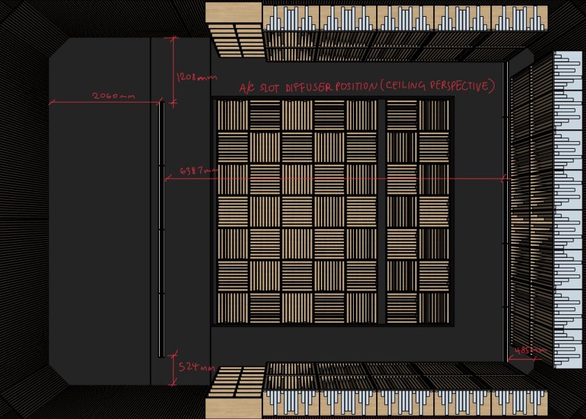

Here's a rendering of the ceiling for determining the positions of the air conditioning outlets, showing extensive usage of quadratic diffusers; P23s x 8 on the front wall, P17s x 20 on the sidewalls, and P11s x 49 on the ceiling canopy, all constructed out of SOLID tropical hardwood sourced from Indonesia (not veneered plywood) with the voids inside chambers filled with dense, waterproofing-sprayed (to mitigate moisture driven deterioration) activated carbon pellets to dampen bass pressure waves.
Wood choices are ebony, sungkai, or teak; now evaluating pros/cons/costs.
Advantages of solid wood include:
- aesthetics and beauty, with contiguous grain structure in 3D throughout
- warping resistance of the thin dividing "fins"
- no VOC off-gassing
- higher density/mass, leading to less absorption of acoustic energy
- uniformity in color, post-varnishing
Disadvantages include:
- high cost
Trying really hard to make my room sound "world class" great! :cool:
- high cost

Not surprisingly, this task never ends, but I'm "getting there"; armed with increasing knowledge, I'm better able to distinguish fact from fiction, and separate the wheat from the chaff.
4) hired the best professional acoustician in town, to assist me in designing and building my new basement audio room
Hey, how else am I able to show everyone the construction drawings and model the predicted acoustic performance of the modules, plates, and diffusers?
5) been auditioning the "sound" of variable diagonal, and off-axis 1D quadratic diffusion (simulation of my sidewall QRD diffuser design for my future audio room), by alternatively turning off one of the L or R channel monoblock amplifiers and doing a "walk around" diagonally to experience what can be heard from the 16-inch deep wall-mounted P17 QRDs. So far, so good! Nothing offensive or deleterious of the cohesiveness to either speaker's direct sound.
Have you ever looked at smt wing diffusers .. particularly the acrylic models .. I have wondered what the dispersion pattern might be .. they look quite interesting

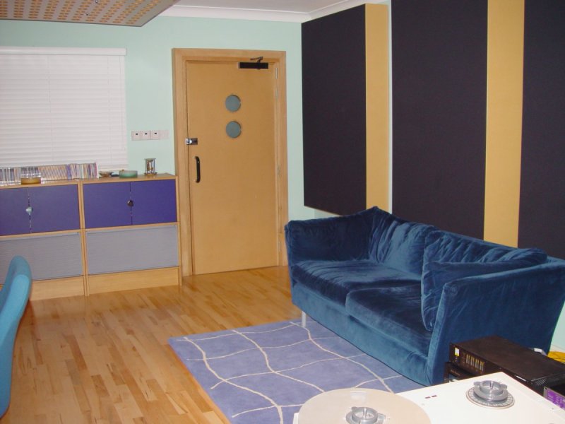

That's the ticket! I was put on to Nick Whittaker and Recording Architecture by the late Billy Woodman of ATC.
Although I have better equipment today, I don't have that amazing room.
I do wish you success in your project.
Reactions: QuadDiffuser
Great,
I am really pleased that you are getting what you want. Knowig what YOU want is half the battle!
Interestingly, I read all the books that I could get my hands on 27 years ago when I was having my studio built in London. I just got confused, as just like in audio, every acoustic engineering expert has a different view on how it should be done.
You hung with Billy Woodman ? Very cool..
Nice plush velvet chairs for you clients ... what era was that
Billy Woodman was a great and very down to earth guy! I bought quite a few pairs of ATCs ( 20s, 50,s & 100s ) back in the early 90s. Those shots were taken around 98.

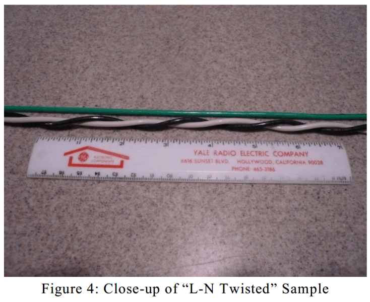

Skipping through a few variations (fig. 5, 6, 7, and 8) to the most elaborate design (fig. 9) submitted for the patent application, purportedly has the best EMI/RFI rejection.
Essentially, it's a four-conductor Star-Quad configuration between the Live and Neutral conductors, with the Ground conductor wrapped in a looser twist. Achieving this twist geometry using DIY methods would be prohibitively difficult due to its complexity.
Perhaps there is a similar design already available today in the marketplace? I'll try looking for it from the usual suspects, ie. Belden.

To overcome the inevitable challenges of "TL:DR" (difficulties in digesting very complicated and lengthy text), I harnessed the power of AI. ChatGPT summarized the patent application as follows:
Optimal Power Cable Configuration (Per the Patent)
1. Twisted Pair for Current-Carrying Wires
The live (L) and neutral (N) conductors (or phase conductors in multi-phase systems) should be twisted together.
The twist pitch should be between 2 to 2,000 times the diameter of the conductor. Why? Twisting ensures that the electromagnetic fields created by the conductors cancel each other out over the cable’s length, reducing induced voltages.
2. Untwisted or Loosely Twisted Ground Wire
The ground (G) wire should not be twisted at the same rate as the live/neutral conductors.
Instead, it should run straight along the cable or be helically wrapped at a much lower pitch than the current-carrying wires. Why? Keeping the ground wire separate ensures that any magnetic flux imbalance does not accumulate along the length of the cable, limiting ground-loop voltages.
3. Maintaining a Constant Distance Between Ground and Current-Carrying Wires
The ground wire should be positioned at a fixed distance from the twisted conductors to equalize the average proximity of each conductor to ground. Why? This prevents the ground conductor from being closer to one current-carrying wire than the other, which would otherwise create an imbalance and induce voltages.
4. Optional: Helical Rotation of the Entire Cable
For long cable runs, the entire assembly (twisted pair + ground wire) can be helically rotated at a different pitch.
The ground wire’s pitch should still be lower than the current-carrying wire’s pitch. Why? This helps maintain cable integrity in installations with bends while still preventing voltage buildup.
