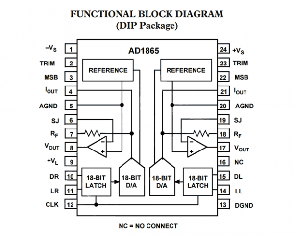

The functioning diagram of the above mentioned AD1865 ...
Each of the devices within this chip is composed of dozens of basic components ( Transistor, Diodes, Coil , Caps, Resistors, etc) .. This assemble cannot by any stretch be called "simple".

18 bits, up to 16X oversampling. The digital processing is usually carried by the filter, typically the SM5813 at that time.
Yes, nothing was onboard with this chip. All digital processing has to be done prior to feeding it into the chip. It has no processing logic. This means simply the chip will accept signals with 18 bits and frequencies up to 705.6 Khz. You can actually feed it 24 bit signals with the right digital receiver chip but the last six bits will be truncated.

You can take the Iout, which is straight off the resistor ladder... The data latch is probably something simple like a TTL flip flop that latches and unlatches depending on the CLK. This is probably one of the simplest DACs ever made on a chip. My point is that it does not have any control logic, digital filters built in (most do) etc. It is probably as close to a discrete DAC concept as was done on a chip because of the temptation to put MORE onto the chip because you can.
Analog Devices tests and grades the DACs at 705.6 KHz, probably knowing of its limitations at this frequency - no one knows what is the real performance at 44.1 kHz. Any way it is not a pure R2R device as some people seem to assume - the four MSBs are segmented, the lower 14 are R2R. And AD does not supply information on what segmentation technique is used for the 4 MSBs.
Yes, it seems to be a kind of hybrid. Interestingly, the Burr Brown PCM63 is a true ladder DAC but gets 20bits by having two 19bit ladders that are interleaved or something...they are summed on the output. Both are great sounding DACs
