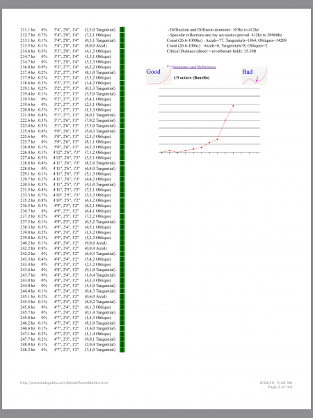

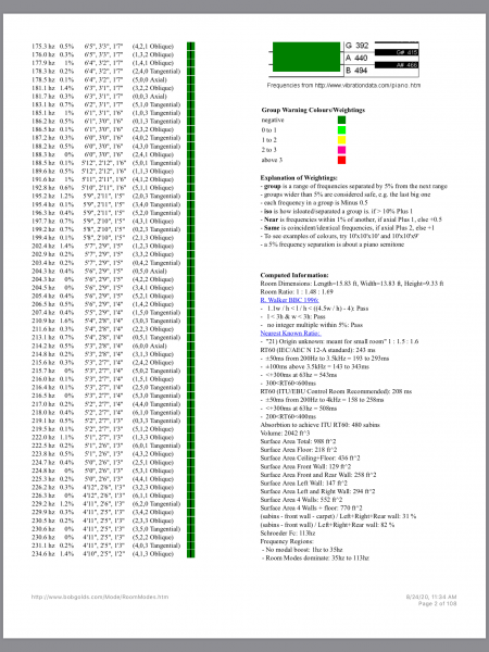

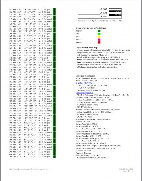

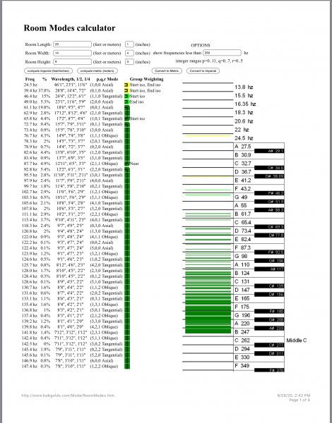

Here are the acoustic assessments done using the tool on Bob Gold’s site. The first is the 14x16 originally planned room. The second is if I were to remove a bathroom and make that 14x21, and the last is if I go with this last space option. But the Gold’s curves do not account for that slanted space that would be behind the left speaker.

Bigger space is almost always better. with a length of 16' the fundamental mode will be 35Hz whereas 23 feet it will be 25 Hz. The lower this mode the better as it takes very, very little energy to excite it. The additional length will also enable you to pull your speakers out further from the front wall.

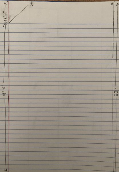

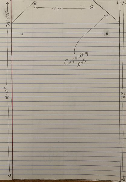

I take your note about the asymmetrical front wall being a problem, @spiritofmusic. I was figuring that would have to get handled somehow. So I’m attaching three scratchy drawings. The first is my attempt to show what the space would look like, proportionately, showing the left wall slant at its proportional length. The second shows what the front wall “flat” length would be if I created a matching “compensating wall” on the right side. You can see it really shortens the length of the front wall. The last drawing shows the approximate starting point locations (the small x’s) for my E SE’s, using Leif’s basic starting locations.
I’m a little worried about the extreme shortening of that front wall once a matching slant is put in. It would suggest having to pull the speakers much further out into the room, to clear the slanted walls, but then - at least according to what I’ve learned so far about my speakers - they’d be too far from the front wall for their ideal positioning.

But Tony, unaltered, you would still have one slanted angle necessitating a compromise on at least one spkr, the left one. That one will still need to be brought forwards. And so with both spkrs needing to be equidistant, you can balance things up building a new false slant.
Or am I missing something?
Nope. You are right on target. My only fear with this is pulling the Endeavor SE’s too far away from the front wall and thus compromising its low end performance.

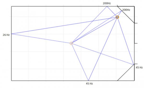

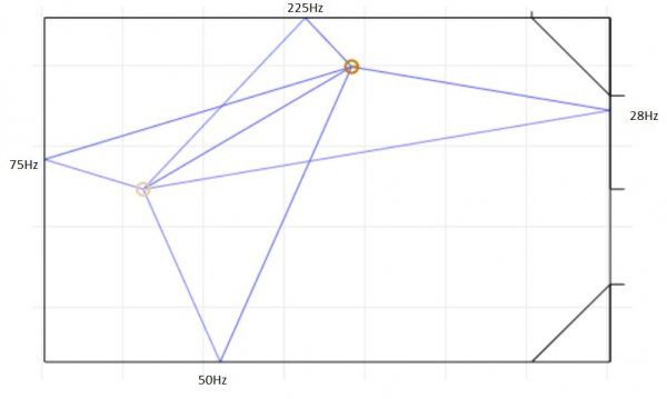

Tony, here is a drawing showing the first reflection points. I assumed you would have your speakers 2 feet from the wall leaving 10' between them and then you would be sitting 10' from the speaker forming an equilateral triangle. I highly doubt this position will produce the best sound in your room. You would be sitting at roughly the half way point where there will be a null and a large peak due to the second room mode. But If you choose this position then I would put a 4" trap behind the speaker on the slanted wall and a 4" trap on the side wall at the first reflection point. a 20" tube stack in the "corner" where the "slant" meets the front wall.
@sbnx, thank you for this! I don’t necessarily ascribe to the equilateral triangle arrangement, but since this is a new room for me that should be taken as a starting point. As I am an amateur when it comes to understanding these things, how far forward or back from the equilateral seating position would I have to move in order to mitigate the null and peak?
I would suspect something like the pic below would be where I would start. The ear in the pic below is 4' from the rear wall. The speaker is 2' from the side wall and the distance to the speaker is 10'. (This is by no means fixed. You have to fish around to find the best spot) Your length modes are basically at 25Hz, 50Hz and 75Hz. Notice how three of the SBIR cancelations are at about those frequencies. You will still need to treat the first reflection at the sidewall with a 4" panel. Any time the sidewall reflection is less than about 6ms the sidewall reflection should be treated or it will mess up the stereo imaging and it just sounds bad (pingy). Also note that this just shows the first order reflections which are the biggest offenders. You will also have a bounce from the ceiling and floor.
The ear in the pic? Is that the lighter circle on the left?
Yes, the listening position is the circle on the left. The speaker is the other circle.
Really? Like this (the E SE is the speaker)? I’m concluding the drawing is showing only the left speaker? As you say, it looks to be about 10’ from the front wall. Wow. The E SE’s are “supposed” to be much closer to the front wall for optimal performance. Color me confused.
Yes, you interpreted the drawing correctly. I only show one speaker as the room is symmetric an you would get the same effect from the right speaker. Finding the best place to sit and speaker location is best done empirically (using measurements is best but by ear is ok...just slower). My room is 28X22 and about 6 months ago I had a pair of smallish floor standers with a single 8" woofer set up with 13' to the front wall behind the speakers. The bass was outstanding. You could feel it thump your chest.
I don't mean any ill respect to speaker manufacturers but it is in their best interest to tell you that their speakers sound great up against the front wall as 95% of people don't have the space to pull them out into the room. My advice is approach this with an open mind and experiment. Try it with the speakers close to the front wall and then try it like the second position with the speakers 10' out into the room.
As an added benefit if you are going to put your gear between the speakers then when you pull them out then you don't get that acoustic interference like you would if the speakers were closer to the wall.
