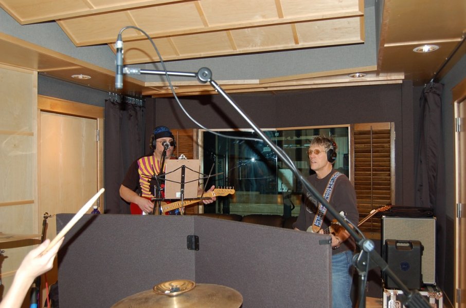

In this pic, I had a "window plug" in the foreground made for the window behind them. Since the window was was in 2pc. with a 20 degree bevel in the middle, the "plug" had to be hinged in the middle.
The "plug" is made of 1x2 and used 2" OC 703 as the insulator. The frame was then convered by Snap-tex
When the "plug" is inserted, it can then be closed off by the shutters. The movable vanes in the shutters then act as a sound diffusor.
