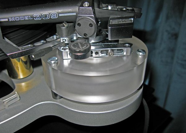

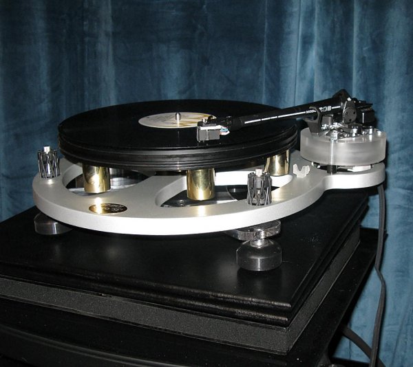

New acrylic armboard for sme arms made and sounds very good.
