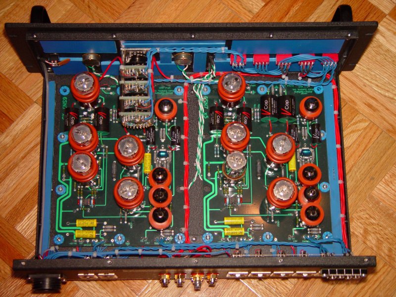

Here's the interior of my preamp. Just a nice simple design by a member here named Ralph. Interesting Microstrip mentioned incompatibility of CR1's with tube pre's.
I wish good preamps where offered with built in crossover options, Krell did in the Phantom, but with limited phase adjustments and it was still a Krell !;)
