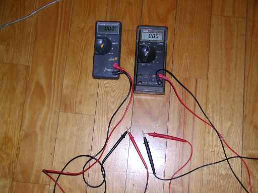

You have to scold your multimeters.
It is not possible to diagnose noise with such an high error in the multimeter. :(
Which probably means the .007 and .008 AC readings aren't real if I can only null down to .007.
Frank and Mep,
I agree ...
I have had my Fluke 77 for over 30 years so I guess it's time for a new meter. In the world I live in, my meter would have been sent out at least yearly to be calibrated, but of course mine has never been calibrated since the day I bought it. It wouldn't be cost effective.
