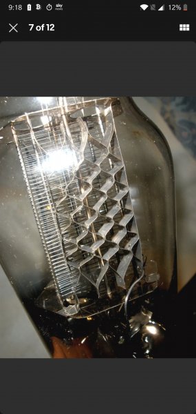

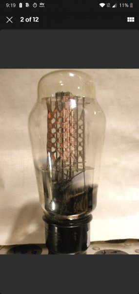

Check out ACPX 4. Mesh plate anode. Another curious 4V 1A triode.
I think this has been on eBay for a very long time. I have never seen another.
That mesh plate anode is ultra cool.
Want.
