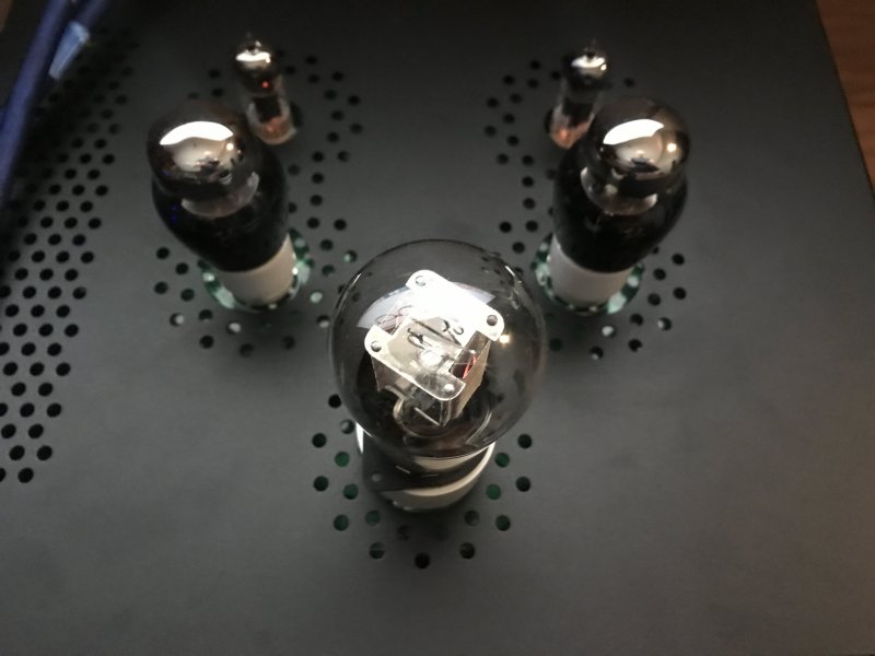

My Baltic 3/4 has never sounded this good, rolling tubes can get a bit frustrating sometimes but then it pays BIG TIME:
I was using until last week:
- VALVO AZ1 140NG WE54TUBE MESH PLATES BIG BULB GLOBE 1930's
- MATCHED PAIR RCA 12BH7 Black Plates D Getter VACUUM TUBES Tested NOS 8.5866-D
- RCA 6SN7/VT231(6F8G+converter), 1940s , USA made! WB
Same time that I purchased the RCAs 6SN7/VT231(6F8G+converter), I asked Rob from LampizatorNA which input tubes he could suggest that fits with my Baltic and he kindly suggested a pair of very reasonable priced AliExpress Chinese Shuguang 50 Years Treasure CV181-Z.
honestly after installing the RCAs I was thinking the Treasures won't even come close and boy I was wrong, more complete and balanced presentation no matter genre.
- Shuguang 50 Years Treasure CV181-Z
Give them a try :cool:

Sablon Audio
Industry Expert, VIP Donor
May 22, 2015
1,618
1,487
553
@Miki70 - I had the original Shuguang Black Treasure cv181 @15 years ago and they were very good, up there with some of the better USA nos 6sn7. Try changing the 12bh7 for early tungsram foil getter ecc40, that may make a bigger impact.
