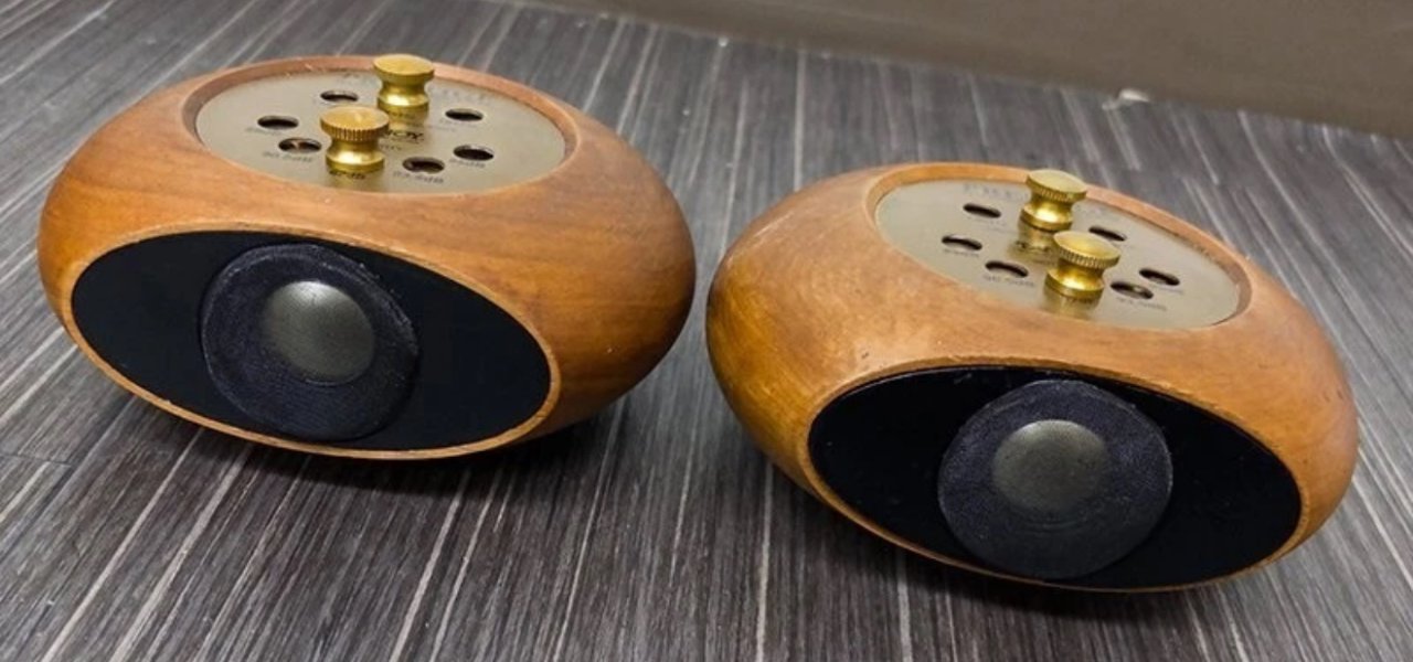

Hi Jeff, did you also try adding a super tweeter at some point? I’ve seen add on tweeters on both the JBLs and on the Vitavoxs. My S2 goes to 14-15k Hz.
The S2 does go higher than the 375. I briefly tried a vintage plasm tweeter but it was clunky.
It seen a few Hartsfields and Vitavox speakers in Asia use the Tannoy super tweeter.
