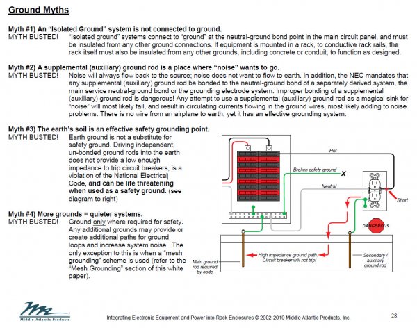

From Henry W. Ott's big new book:
3.1.7 Grounding Myths
More myths exist relating to the field of grounding than any other area of electrical engineering. The more common of these are as follows:
1. The earth is a low-impedance path for ground current. False, the impedance of the earth is orders of magnitude greater than the impedance of a copper conductor.
2. The earth is an equipotential. False, this is clearly not true by the result of (1 above).
3. The impedance of a conductor is determined by its resistance. False, what happened to the concept of inductive reactance?
4. To operate with low noise, a circuit or system must be connected to an earth ground. False, because airplanes, satellites, cars and battery powered laptop computers all operate fine without a ground connection. As a mater of fact, an earth ground is more likely to be the cause of noise problem. More electronic system noise problems are resolved by removing (or isolating) a circuit from earth ground that by connecting it to earth ground.
5. To reduce noise, an electronic system should be connected to a separate “quiet ground” by using a separate, isolated ground rod. False, in addition to being untrue, this approach is dangerous and violates the requirements of the NEC (electrical code/rules).
6. An earth ground is unidirectional, with current only flowing into the ground. False, because current must flow in loops, any current that flows into the ground must also flow out of the ground somewhere else.
7. An isolated AC power receptacle is not grounded. False, the term “isolated” refers only to the method by which a receptacle is grounded, not if it is grounded.
8. A system designer can name ground conductors by the type of the current that they should carry (i.e., signal, power, lightning, digital, analog, quiet, noisy, etc.), and the electrons will comply and only flow in the appropriately designated conductors. Obviously false.

The use of independent earth/ground electrodes is now understood to create a safety hazard. During a lightning strike or when earth fault conditions occur in medium and high voltage power distribution, independent soil electrodes can take on very different voltages, with transients exceeding 10,000 volts. This can cause electrical shock, showering arcs, toxic fumes, smoke, equipment damage, personnel burns and serious fire. This type of bonding is also very poor for interference control purposes.
While it is unlikely (these days) to come across this type of grounding conductor topology, I have included this short explanation of why independent grounds are a major problem, because I have had to face this type of system on a few occasions. The large potential differences between different ground points in the system are not only dangerous, but cause enormous problems in controlling low frequency noise and are completely useless for controlling high frequency interference.
