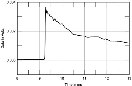

Dunlavy SC-IV
"Look at the SC-IV's step response in fig.4. Pretty ideal—the outputs of all the drive-units arrive at the microphone at pretty much the same time. This, by definition, is time coherence. As a result, the SC-IV is one of the only two loudspeakers I've encountered that can produce a good squarewave shape. "
Here we see, in an old Dunlavy review, JA using the term time coherence in a very different way from what he uses it in the Alexx V review. He now would call this time coincidence but in the older review he is still using the accepted terminology and has yet to invent his own. As this review is from 1994, I guess Wilson had not yet taken over the audio world...
From the Alexx V review:
"But other than those admittedly minor issues, the Alexx V's step response is time-coherent on this axis (footnote 2), implying optimal crossover implementation."
" I should clear up some readers' confusion about my use of the terms "time-coherent" and "time-coincident" with multiway loudspeakers. The latter means that the outputs of the drive-units arrive at the nominal listening/microphone position at the same time. The step response is therefore a right triangle—a vertical rise from zero with then a slow decay to the timeline. This is very difficult to arrange—the only dynamic speakers I have measured that were truly time-coincident have been various Spicas, Thiels, Dunlavys, and Vandersteens. By "time-coherent," I mean that when the crossover's phase shift in the crossover region and the different distances of the acoustic centers of the drive-units from the listening/microphone position are taken into account, the result is a step response where the decay of each unit's step smoothly blends with the start of the step of the next lower in frequency. To the ear, the difference between perfect time-coincidence and perfect time coherence is relatively minor."
See, he has changed the definition rather dramatically from the, more correct, usage with the Dunlavy, Thiel and Vandersteen reviews.
