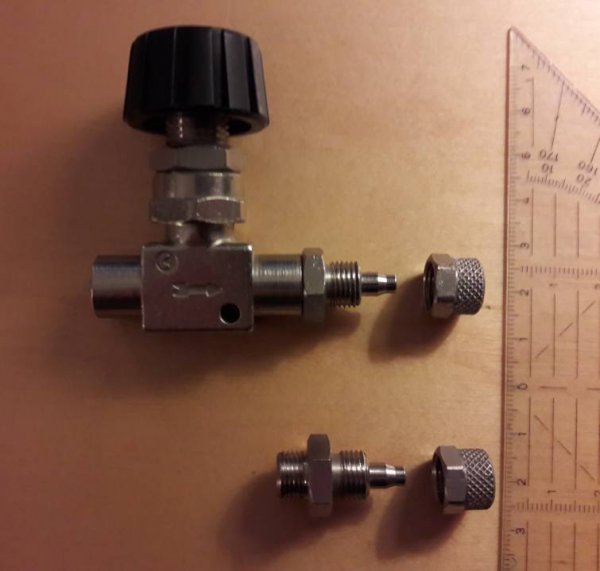

Since this thread deals with air bearing turntables I will ask for help here. My air bearing turntable uses this type of valves and pneumatic fittings and I am needing a few of each of them. Does any one know what are the correct designations of them, and it would be even better, a supplier in Europe? An eBay seller would be great! The ruler scale is mm, although threads are imperial.
