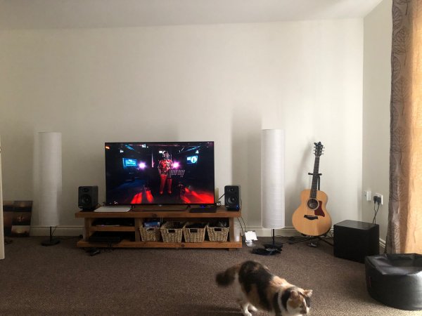

Hi all
I own pair of steljes ns3 speakers connected to my tv via optical which I love. Few days ago I’ve purchased kef kube1 subwoofer, and tbh I have no idea how to set things on back(crossover, volume, phase ets) of the sub to get the best out of my setup. So can some experience audio members help me with this. Thank you in advance. Any tips on sub placement in my living room are welcome as well.

Placement is hit or miss and can be changed if required. You want it where you get the smoothest LF response. Best done with test signals and an SPL meter or run a LF sweep and you can clearly hear the peaks and nulls. You could just start with where it is or move it away from the corner to say the other side of your TV as a quick comparison.
First thing to figure out is phase. It's simple use music or a test disk that has lots of LF content and flip the switch. Have the sub frequency turn as high as you can go so you have lots of overlap with your mains. Set the sub so it's as loud, level matched with your mains. I see that your sub has EQ set at 0. You can always experiment later. Phase switch position with most bass is the correct setting.
Then set your frequency to around 60Hz try to level match the sub and your mains and see how it sounds. Then just try adjusting frequency and level as you see what sounds best. When it sounds good see how you like the EQ in different positions.
It would be better if you had an SPL meter and an HT Set up DVD as these would supply you with specialized test signals for sub-woofer set-up. You can certainly start by ear to get things going. Have fun and good luck
