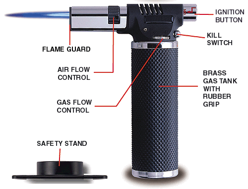

I also started with a gun, unfortunately the mass of the connector is too much to be able to heat properly and poor "cold" welds can follow. Keep the torch too close too long and you melt off the gold or burn the copper and melt some insulation.
It is a straightforward learning process, guaranteed you will destroy 1-3 connectors so buy extra.
The Autobarn model works very well for me:
W-mart has Ronson butane look like my Euro Nivea spray deodorants a bit.
Heat shrink tubing works great, first make sure you crimp at leat 3-4" past the weld point then slide the heat shrink tubing and cover far away over the cable, that way the insulation will not melt. Then bring back the heat shink tubing, shrink it over, then slide the silicone cover for that clean look.

That is a nice looking little torch! My old 100/140 W gun worked fine on 10 AWG IIRC. For bigger stuff I had a 210/260 W gun (do not have that one anymore). I almost always lost some insulation near the connector due to heat transfer from the wires melting it off. I have very rarely used silver solder, too much hassle for questionable electrical benefit (for me, YMMV).
"W-mart has Ronson butane look like my Euro Nivea spray deodorants a bit." Probably want to be careful about sticking the torch in the bathroom medicine cabinet... :)

Problem with a butane torch with large gauge wire is that butane is not hot enough to get the solder cooking fast. You might want to try a MAPP torch instead as that works faster, melts the silver solder faster so that the wire itself doesn't heat up too far up the insulation. One that we use is by Bernzomatic.
