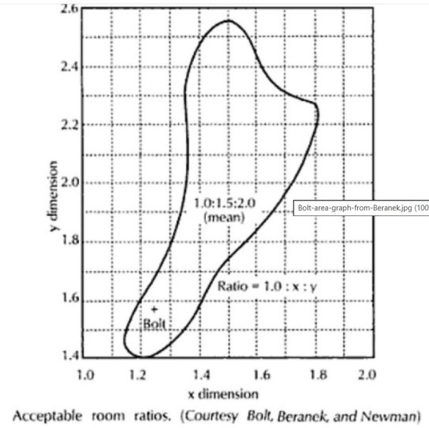

To minimize low-frequency resonances, acousticians (R Bolt specifically) recommend using “ideal” room dimension ratios: 1 (H) × 1.9 × 1.4 or 1 × 1.3 × 1.5 × 2.1.
Additionally, it seems that for better results the room should have a volume of at least 40m³ (1400ft).
Hi Greg, the formula is a bit confusing here give the four numbers. Can you tell me what each one represents and maybe walk through an example?
For example, which is length, width, and height…and what does the fourth term represent?
