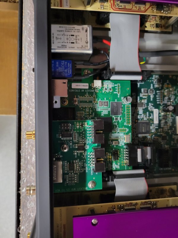

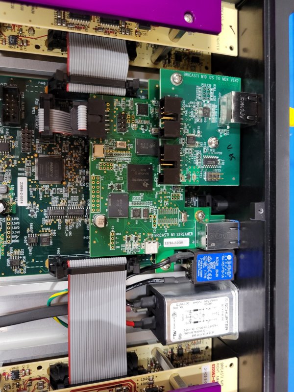

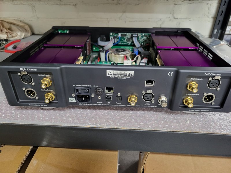

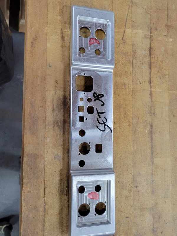

My M12 now has been updated with dual ports, an I2S super-performance to be used with the new Bricasti M19 transport and also an Ethernet connection for streaming. Took about 1-1/2 hours to complete, see attached video of the CNC machine (still trying to upload video). at work at the Bricasti factory. A HUGE thank you goes out to Joe and all the guys & gals at the factory, they are the BEST!
Beautiful! My m21 shipped today, so I am looking forward to hearing it. With that said, how does the m19 sound now that it's hooked up i2S?
