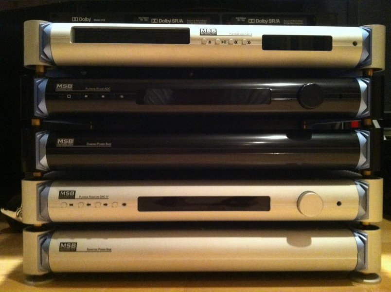

I used to have a MSB stack... was quite good!
