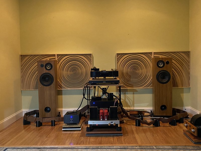

Cellcbern
Jul 30, 2015
1,224
729
585
71
Washington, DC
There is a third option beyond absorption & diffusion panels. I have done direct comparison testing between a combination of RPG BAD and Gik absoption panels, and the ZR Acoustics panels and found the latter to be significantly better even with less than the recommended sf of wall coverage. Keeping the RPG BAD panels for the side and rear walls, and ceiling (at least for now), but the ZR Acoustics panels behind the speakers are a dramatic iprovement. See my posts on the subject. ZR Acoustics panels.jpg
