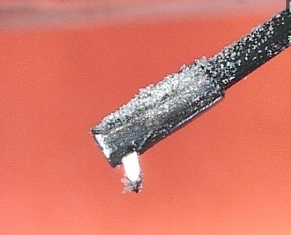

diamond has come loose in my cantilever, ideas to repair ??

this is the cantilever from a ZYX Optimum. Before on top, after (as it is now) in the green color picture. I pushed it back (picture with orange background) and thinking a dab of adhesive on the top will fix it, but don't want to ruin a $10K cartridge
. Initial indication from the distributor is that ZYX in Japan will require me to pay to have it "retipped", which in the ZYX world means you buy a new cartridge at a discount. It only has a few hundred hours on it so do not want to pay for another $10K cartridge even at a discount.
ideas?

this is the cantilever from a ZYX Optimum. Before on top, after (as it is now) in the color picture. It appears the adhesive has failed as the diamond is pushed up into the cantilever. Initial indication from the distributor is that ZYX in Japan will require me to pay to have it "retipped", which in the ZYX world means you buy a new cartridge at a discount. It only has a few hundred hours on it so do not want to pay for another $10K cartridge even at a discount. Seems to me it could be pushed down and re-glued but I wouldn't know what glue to use and not sure I have the dexterity to pull it off.
ideas?

that is yet to be determined so don't want to cast stones just yet. But the distributor told me that in similar situations that was their position. I'm thinking if it is just a matter of applying some adhesive then I can get it done on this side of the Pacific and save shipping and insurance on sending a $10K cartridge forth and back from Japan.
If the shaft the stylus fits in is tight and not deformed you will hopefully retain the same zenith and azimuth alignments however it seems likely that the SRA could alter slightly if the stylus is even a little off the previous position on its shank length. iow cart might require a new sra adjustment. The glue may add minor additional mass to the stylus assembly too but maybe not as there was likely some glue before.

A quick inquiry to a few good cart repair people will tell you if someone that works on carts everyday would make the glue repair or want to replace the whole assembly ( and if they can access the carbon assembly ). Their take on it might inform your next step.

Sending it to the manufacturer to be repaired may not be an option. If ZYX declares that it can't be repaired then replacement is the only option from them. I am waiting to see if they will make a determination based on the photos. If they insist I send it to them for evaluation which is likely, then I am out several hundred $$ in insured shipping for a round trip if they declare it unrepairable and I choose not to buy a new one. I will not buy a new one.

Seems like minor damage if this is the only damage off course , did it just fall out or did you damage it / drop it .

A repair is preferably done by a cart specialist with a microscope off course ,so he can check for other damage as well / clean the cart

it never came out, just pushed up as in the middle picture. I was going through an alignment, raising/lowering it onto the record and all of the sudden after I lowered it the arm just skated across the record. When I looked with my USB microscope the reason was obvious, the stylus was no longer getting into the groove. If I don't get a good answer once I hear back from ZYX I will take your suggestion and contact Van den Hul... thanks for the suggestion

Then it looks like it wasnt properly glued in the first place .
In that case it would be a guarantee / after sales problem for the dealer / importer .
(If you bought it new )
Looks to me a fairly easy repair anyway .

I’m very sorry to hear that. How old is that cartridge? I would DEFINITELY not try to “fix” it yourself. You could make things worse. The second you try to do anything, you lose all hope of having the manufacturer fix it. I would send an email or call Peter Lederman at Soundsmith, he has a great reputation for repairing and rebuilding or retipping many different cartridges. He supposedly does great work.

thanks for all of the advice and suggestions. After my initial conversations with the distributor it appeared they were not going to take care of it. Now, all indications are that they will. ZYZ has indicated they will be able to repair it. Not definite until they get it back but looking good.
In hindsight I probably should have been more patient, but when I thought I might have to eat $7K to have things back to normal I freaked out a bit. I'll post the final result but for now I am assuming that ZYX is going to take care of me

first of all sending it back to ZYX should not be considered like sending it to where it was manufactured. most cartridge manufacturers buying cantilevers fitted with styluses directly from one of 3 companies. in ZYX's case it's Namiki I believe. so ZYX is going to fix it their own way far from original factory's cause normally they're not fixing styluses to cantilevers. it's not their profession. on the other hand if you ask Namiki I don't think they will offer a repair service.
I would try to fix it myself it doesn't look hard but I'm quite handy with this kind of work. if you're not try to find a good local repair service maybe a watch repair service can help. best option may be Wally Analog or Soundsmith as mentioned by other members. in worst case you will need it to be retipped. just consider that even if you made it fixed by ZYX with a glue the result may not be satisfactory due to reasons I mentioned above and you may still end up retipping. high priced cartridge does not mean high build quality and ZYX is no exception. usually a good or exotic case.

One possible reason for the damage seen in the photo is that the glue that fixes the stylus to the cantilever was solved.
