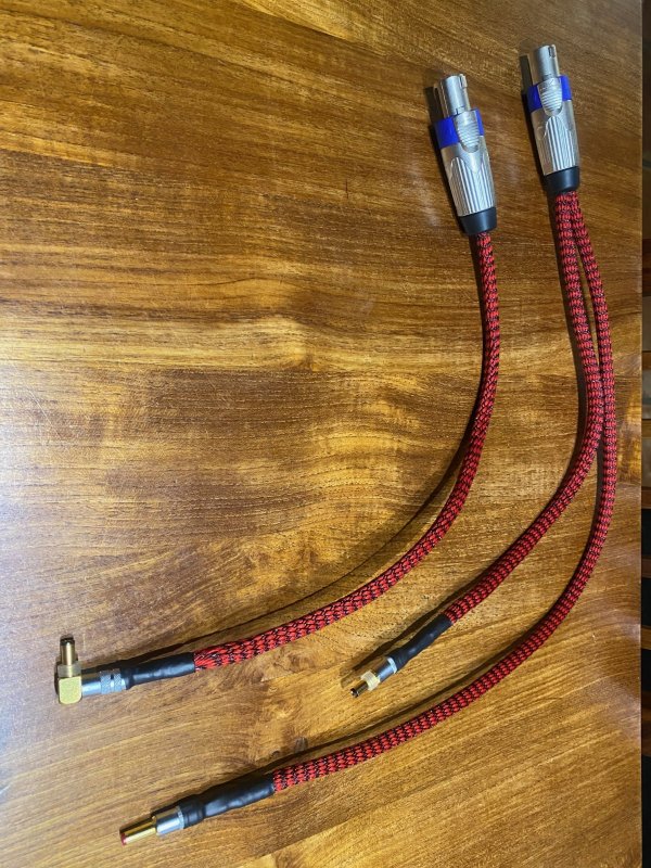

I have made two cables for the Jcat Optimo 3 Duo with 1mm diameter Mundorf silver-gold alloy wire, quad-star architecture (two wires for the positive and two for the negative, alternating), lined with cotton sheath, with rotation in the clockwise direction and shielding of a single layer, of copper sheath and connected to the terminal of the connector that leads to ground on the Optimo. One of the cables has two outputs, one for the JCAT USB XE card and the other for the OXCO MASTER JCAT clock. The other cable is for an NVME Femto SSD with the library. From the first moment the change has been spectacular. Carlos
Great result! Thanks for sharing. I read before (but did not try) that starquad DC cables can yield better results than twisted pair/biwire.
Did you use shielded or unshielded Mundorf SGW 110?
I find it interesting that you prefer copper sheath as outer wrap (instead of braided copper)? Did you compare both maybe?
Yes, I used Mundorf thread with Teflon coating and I put a cotton cover and shielding with braided copper. Carlos
