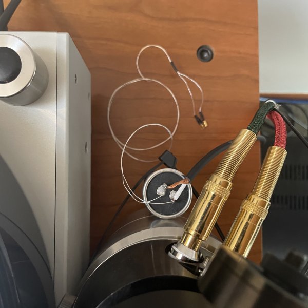

I just used a heavier gauge twin cardas copper litz wire from tube rectified psu to near tonearmbase...there I hooked it up to an Audio Note Kaisei 10.000µF capacitor as last filtering stage as close to cart as possible
then I hooked up the enclosed thin silver dc wire from Kaisei and along the arm tube to the dc terminals on the cart
result more body and slam
Audiophile Bill did too and experienced the same(actually he was first)

Imagine a constant wire from PSU DC output to cartridge DC pins. All you need to do is splice in the cap, as close to the arm as you can. You can replace the section of wire from cap to PSU with better quality cable if you want (thicker). I used the supplied black cable that Darius sent with my tube PSU. Maybe I will change to Cardas at some point.

I will let the tech experts comment on the cap. I copied what Leif used. As for the power cable, I don’t think you want anything that big. If you scroll back a ways in this thread you can see the Cardas that Leif used. I think it was something like 21-22 AWG. My thicker comment was in regards to the tiny silver wire that is used from the cartridge.
the cap most certainly will influence sound
my first was the Elna Cerafine 6.800/50v...slightly mellower than the AN Kaisei
other contenders would be Panasonic Fc, or best a 16v film cap of as high µF as possible...
also you can always start with 4700µF and double /add and stop when you think it is enough/too much
