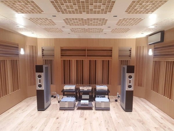

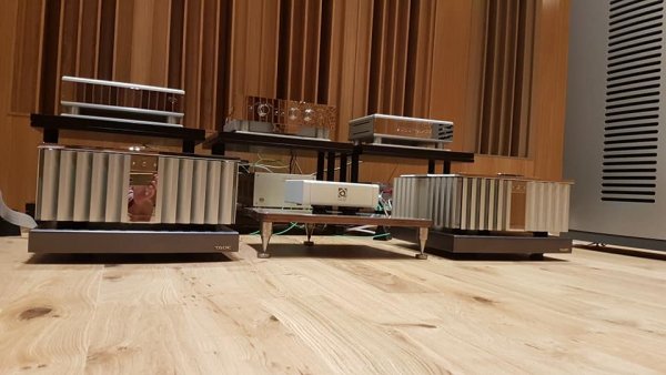

Nice set up. I think it is to do with bias current adjustment. You will need a technician to adjust the bias to the reference specs. I would suggest you call Burmester directly and they will help you out if your dealer isn’t cooperative.
Burmester Reference Line set-up.

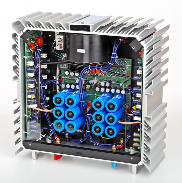

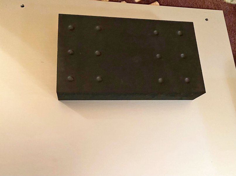

I recently got a 911 Mk3 and it sounds fantastic when driving my Rockport Atria2 speakers.
Since I'm not a technical guy, I wonder if someone can explain the construction. When I took the top cover off, I noticed that there is a foam block attached to the inside. The foam block seems to be pressed against the 12 blue capacitors (?). Is this for dampening purposes?
What's the purpose of the 3 clear plastic shields around the power supply, and the L & R boards?

Hi, while I’m not a techie either, what I understand is that the foam is indeed used for damping the caps. The rest I won’t be able to help you with. As an aside, I have heard another identical set up with the 911 stereo driving the Altria’s and they sounded amazing
I wish that other brands would pay more attention to vibration control. I use the Arya RevOpod footers with the 911 and find them really beneficial. I also notice that the 911 chassis is "open" with narrow slits (2-3mm) at each corner. This may help the 911 stay cool even when playing loudly.
