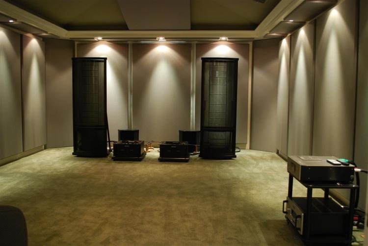

Building my room in 2013 I chose to build soffit traps as Bruce Brown did. I framed down 10" x 16" wide around the room. This is open to the dead space above the ceiling. I filled the soffit and 3' wide and the varying height in the ceiling. I made frames and covered it with the same Gulf of Maine fabric as the walls.
